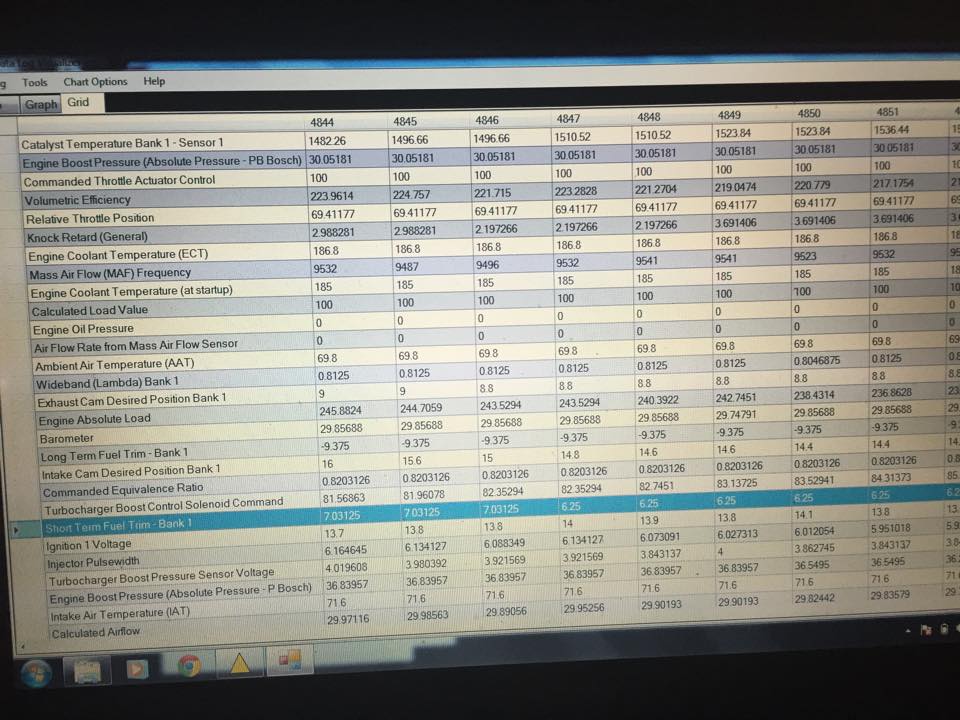

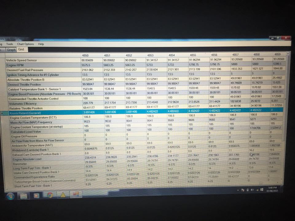

So after finally logging my fully bolted stock turbo LNF, I've noticed we are knocking... the trims are fucked also. Yet Steven from trifecta views the file when its sent to him and thinks it needs 0 revisions.

That's not cool. The knock is probably because the trims are off be both those issues are easily fixable

Last I heard is he's not wanting to change it because supposedly they all knock/its false knock. I don't think thats false knock at all.
honestly about to get it hptuned.

You should not have knock at WOT end of story, which you pedal command is 99.9% so WOT. Tip in knock is different but thats not WOT.
Also a lambda of 0.81 is stupid rich on direct injection and your LTFT at -9 with your STFT at +6 for a WOT pull is not good at all

They're just stupid. I tried to get a revision from them and they made everything worse and said it looked good to them.

There should be zero knock at wot. Too rich as well

So back to the OP, What exactly is that Grid showing? Is that the max knock registered for an entire log? Because its really hard to tell at what RPM the knock is at and under what conditions.
If the log was done before fully warmed then I could see 3 degrees of false knock easily
Old Aug 11, 2015 | 11:26 AM
You can see rpm, kr, maf, boost, load all in the pics he posted
Oh i didn;t correlate the RPM at the top.
Yeah 4.5 at WOT in that high of RPM is ridiculous. Especially at 13.5 timing.
