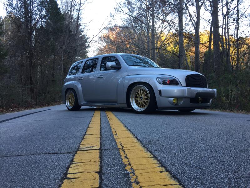

did some upgrades haha
olga_00Z by DS_Mastery, on Flickr

Just out there killin it. Looks damn good! real or not lol

Haha thanks, trying somethings for fun

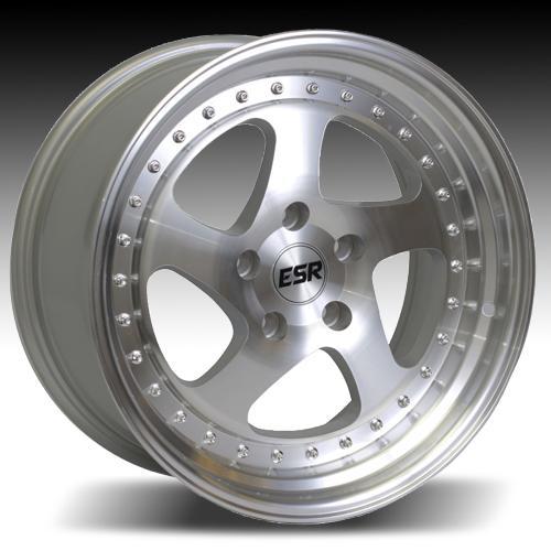

Getting new wheels very soon...yes I've only had my STR's for like 4 months but I'm wanting something wider. What are y'alls thoughts on these for my HHR?
18x9.5 +35
The also have them in Gold with the polished lip if I want to keep my whole gold thing going. I'm kinda thinking the silver will look cleaner and I'm getting my roof wrapped in satin black soon too.

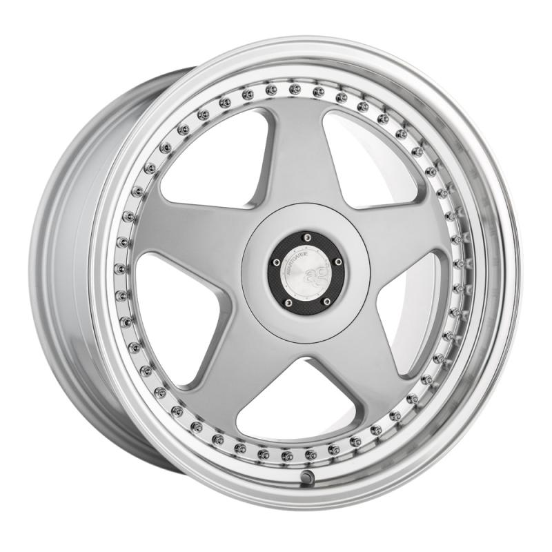

Making a final wheel change...going with Advant Garde M240 in 18x9 +25 or +21...still have to decide the offset. I'm wanting to get away from the knockoffs and go with something solid.

no +30 or +35 available? +25 will work, i just dont know how well they will fit. inner clearance will be fine.

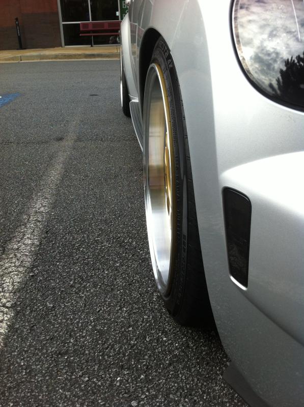

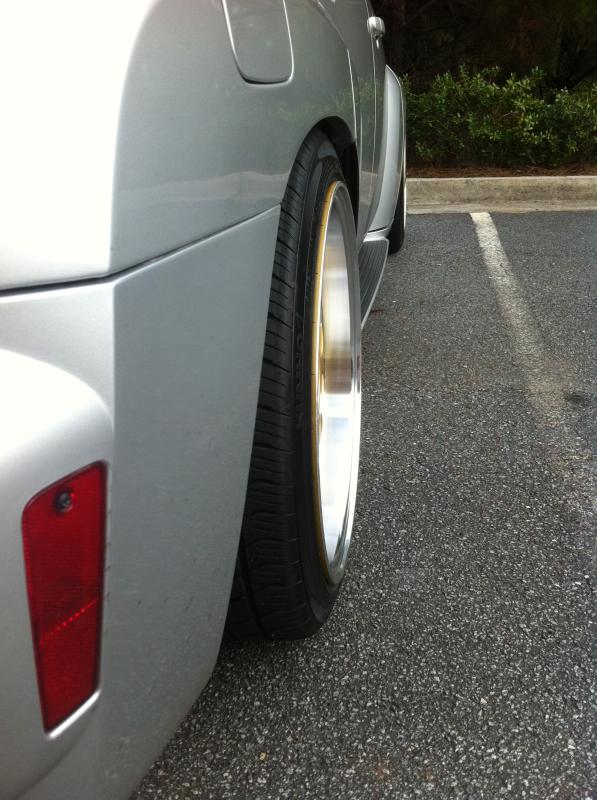

I can get them however I want...+30 would work great in the back with very little rolling needed. The fronts I really think need to be +25 but hell IDK. Here's what I've got now with my 18x8.5 +30...
Rear:
Front:

with the 9wide your freeing up half inch over the 9.5 u planned on. now the offset is lower
9.5 +35 would been rubbing inside, 9 +30 or +25 would be fine inside just need some rolling and it wont rub as much.
18x9 +30 would be good, +35 would be better. fitment wise, im not sure what look you going for haha
I'm just wanting a nice flush look...not wanting anything extreme or crazy. +35 would get me about where I am now with the 18x8.5 +30. I'm thinking the 18x9 +30 will be great for the back and I don't want to stagger them so +30 will have to work up front too.
