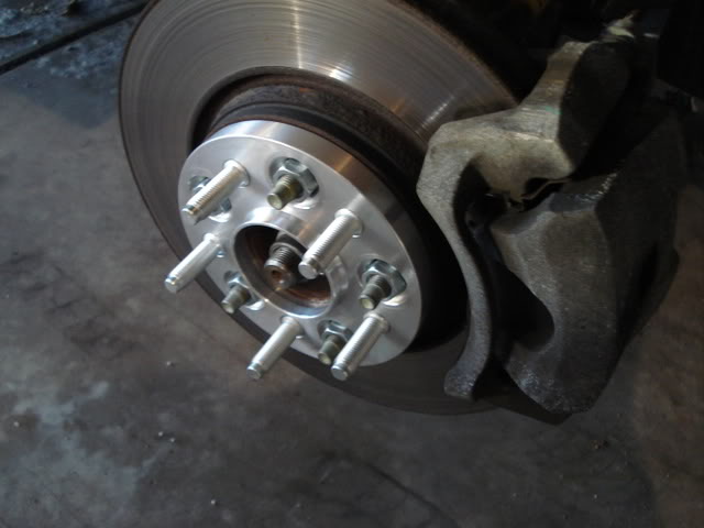

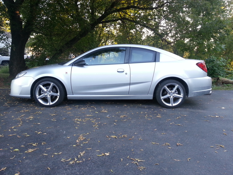

15mm minimum.

And you need adapters. Spacers won't cut it.

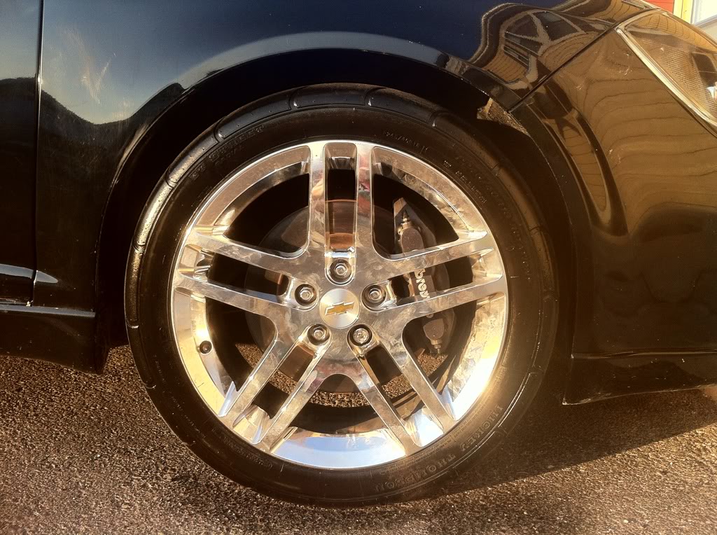

Just polish the stockers, if you're just interested in the chrome look
lol ya right..how long did that take.
Old Sep 21, 2012 | 07:29 AM
TX.SS.TC's Avatar
Joined: 03-25-11
Posts: 1,620
From: DFW, Texas
I actually bought them from a member like this, I don't remember the exact time but it didn't take crazy long
