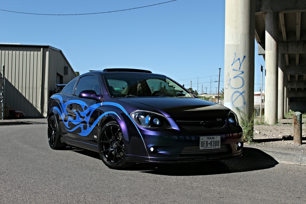

I had them on my Balt for about a month, I loved the drop since I didn't want something so so low and be hitting everything,
but I thought the ride quality was bad but it ended up my tires where crap and made all road feel horrible, so I sold them but I wish I would of kept them although I'm really happy with my yyz springs atm
Ottp(old paint job)
Yyz (rear is a tad higher)
Ottp(old paint job)
L]
Fun to play 'spot the differences' between your two pictures :lol;
