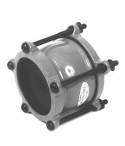

For instance:
This one may not be air tight.
This one would be airtight, requires welding, and doesn't give for movement or small misalignments. (Each half is welded to the pipe, and then they are pressed together, with a seal in between, and t-bolted together.
This one would be possibly airtight and would resist them backing out, but doesn't allow for much movement or any misalignment. It'd probably be a pain in the butt for us to install in our cases too.
All may be good in some ways but not in others.
