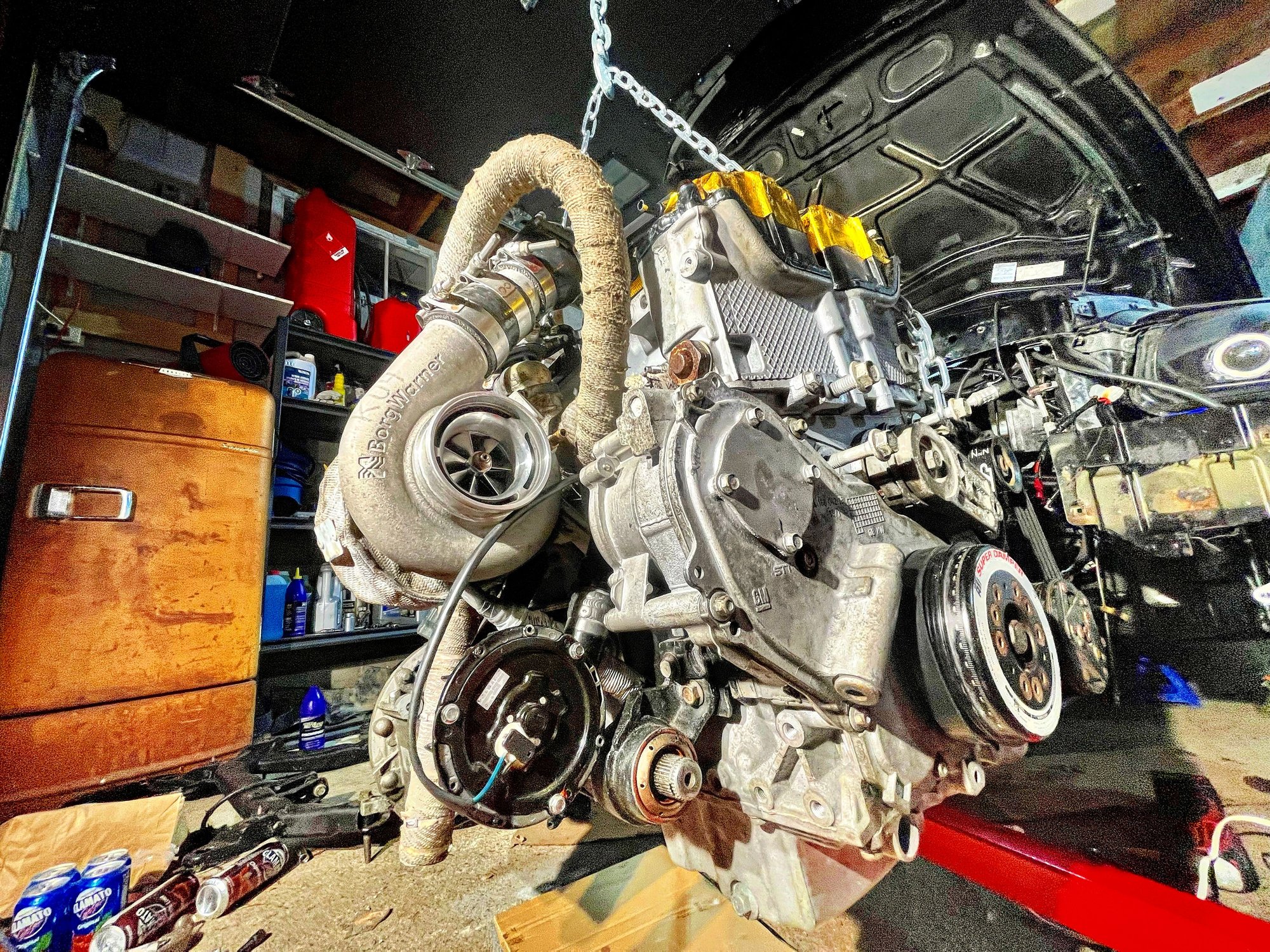

The car has ~200k on it so I decided it was probably as good a time as ever to put a ZFR/TR10 on it.... I also did the timing chain and walnut blasted the intake.
I've been passively working on the car in between other projects and actually got the car back together last week. I found out my RR caliper is locked up and been waiting on the replacement from RA since Thanksgiving...however I did take the car around the block and all my gears do gear things. I'm not going to ever track this car and it's more of a quick DD, so I did a budget build... I think if you were looking for best setup it would be better to investigate what some others did with the equal length axle setups. Here's what I ended up doing for the swap, along with install notes. I'll update more once I get some time on the car.

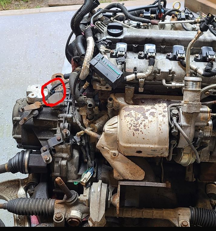

Tough to see, but F35 reverse light switch is mounted on the top of the trans

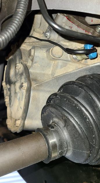

F23 Reverse light switch is on the back of the trans next to the diff.

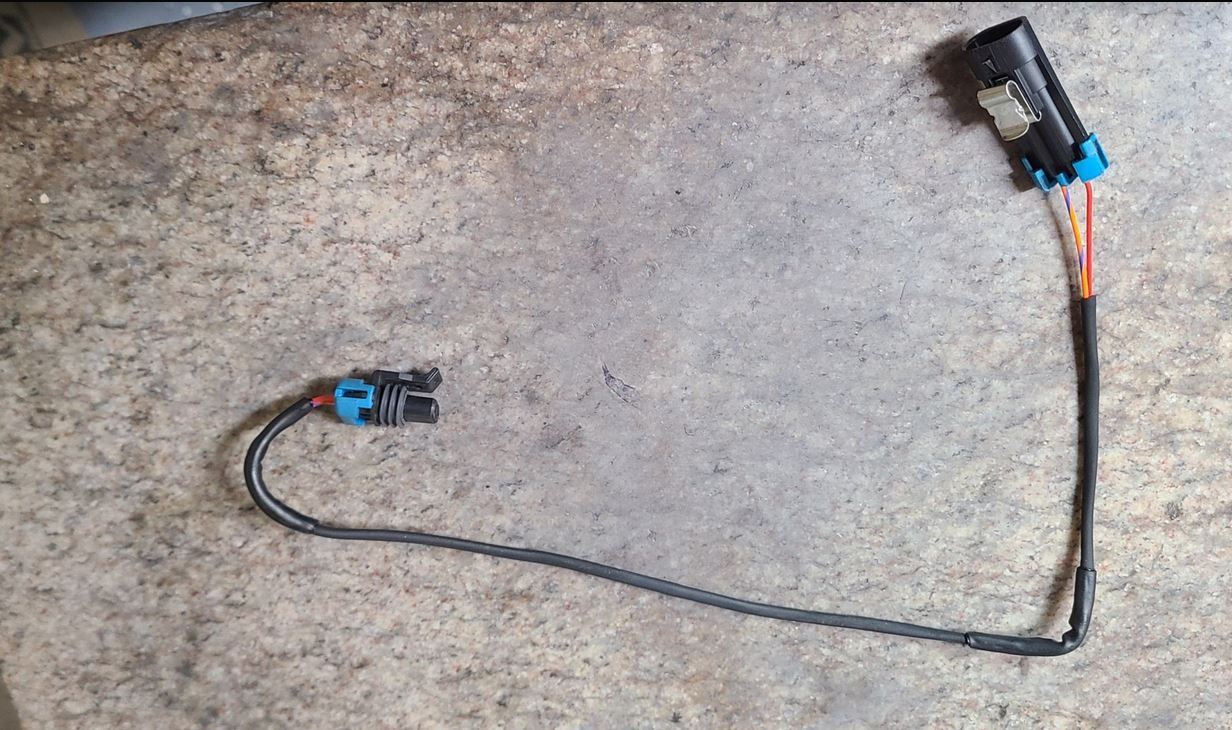

Had an old LS1 knock sensor harness laying around that happened to be the correct female plug to extend the factory wiring. It's probably easier for most to cut the wires on the factory harness then extend them with butt connectors. I happened to have the correct connectors so I opted to make an extension harness.

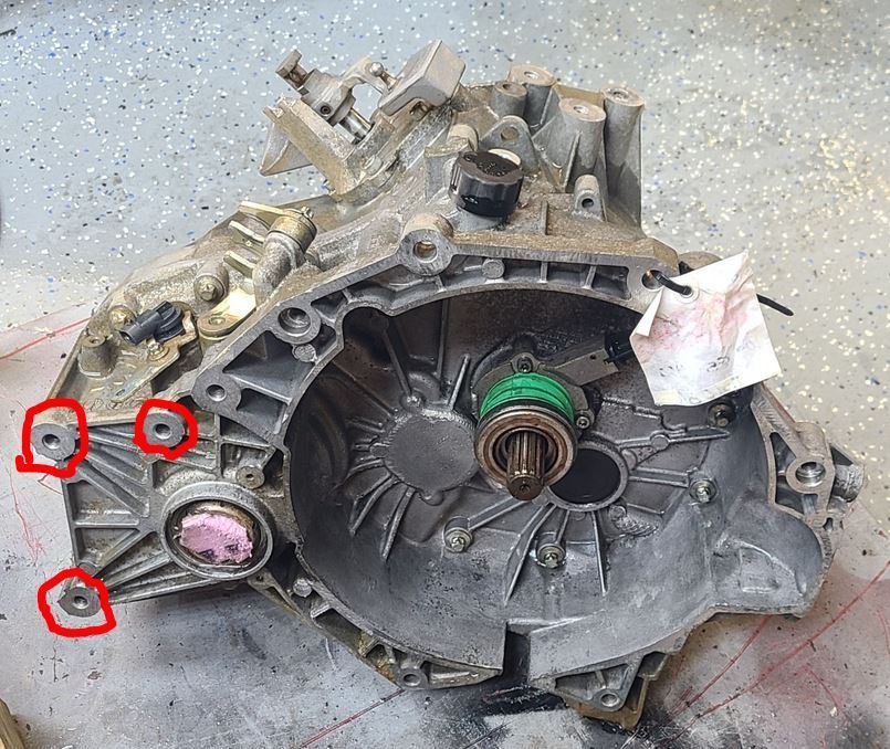

F23 has 'lil guy bolts here, F35 are M10. I opted to drill and tap the F23. I think there was another couple holes that also needed to be drilled and tapped to the M10 bolts, but I can't recall. It'll be obvious when you try putting on the F23 mounts reusing the F35 hardware.
