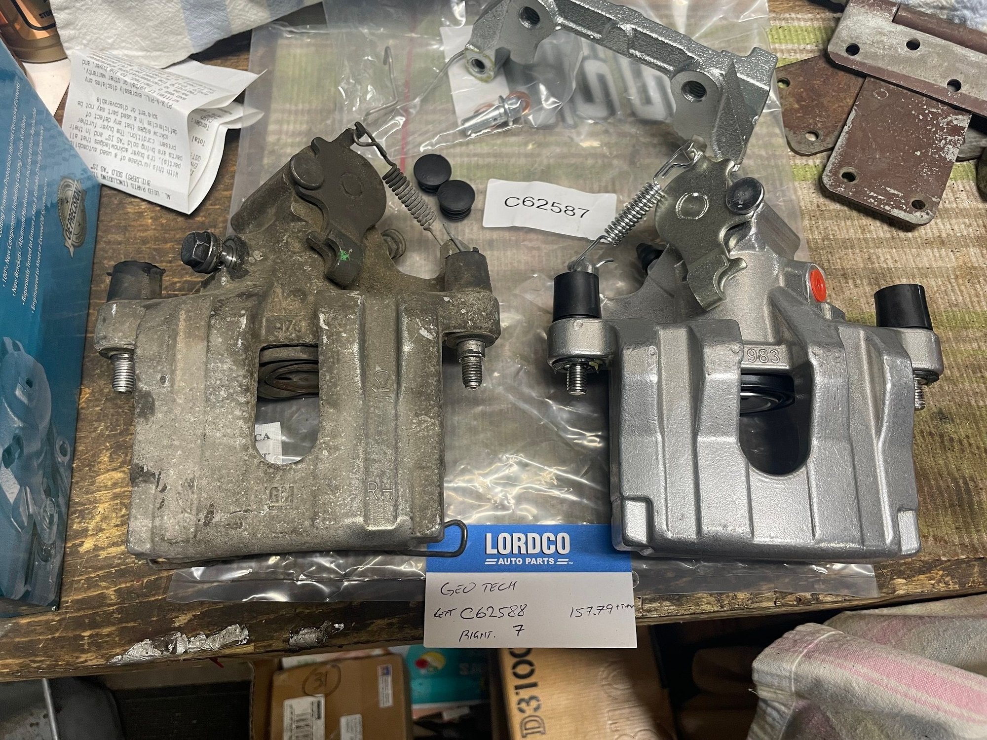

Here is a picture (my Cobalt caliper is damaged at the parking brake return spring tab):
What you're seeing here is an OEM Cobalt SS left caliper on the left side;
If you look closely you can even see the "LH" in the casting (bottom far left);
This is beside a replacement (new, not rebuilt) right side caliper for the Solstice.
The bag for the caliper is under them both;
On the foreground is the part numbers for both sides;
The card shows:
LEFT C62588
RIGHT C62587 (only the last number is shown because that's the difference)
The bag shows C62587 - so this is a Solstice RH part - but it exactly matches the Cobalt part (once the bracket is removed);
I have the Solstice bracket removed from the caliper, and sitting in the background.

And just incase, here is a Cobalt-Rear/Right against the Solstice-Rear/Right:
(you can see the "RH" casted into the OEM part - on the right side)
