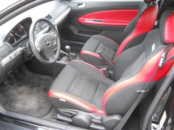

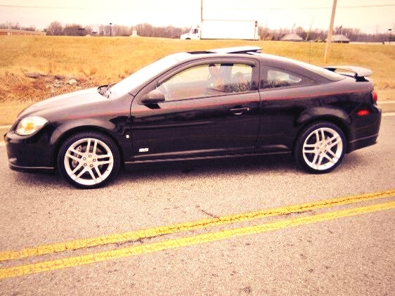

Added pics! Probably crappy from phone

welcome rookie. now post some.pics.

Thanks everyone ! Really appreciate the input ! I added some pics it's nothing fancy yet lol came with the LSD and red seat options that's about it.. I wanted the big spoiler

Welcome, car looks great! I'd remove that pinstripe though. Just get a K&N intake. No reason to get a BOV unless you go to a bigger turbo which requires one. You could look into a Forge BPV, but you'll be surprised with how loud just the K&N is.
