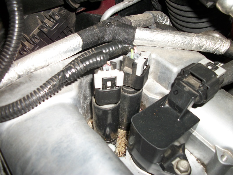

Do you have a picture of where these phaser solenoids are located?
Are those the two things in the valve cover next to cyl#1?
Old Jun 28, 2014 | 12:49 PM
  #77
tuned08ss's Avatar
Joined: 09-15-12
Posts: 1,988
Likes: 18
From: South Jersey
Yes

Somebody wants pics of phasers, somebody gets pics of phasers
Leaky little bastards.

+1 thank you
Are those GM part brand or denso brand?
