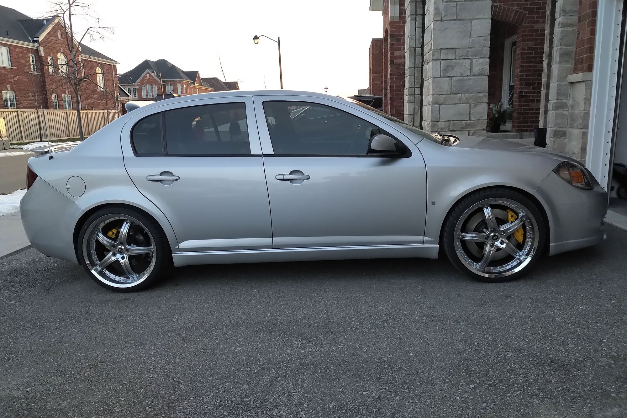

Just installed yesterday. Do I need it for my street driven ss? No. But it is what I want over need/require. The 14.5 brake kit to fill out my large opening with the 20” wheels. It looks odd with the stock rotors creating too much space in between rotors and rims. wish there is a larger rotor option for the rear.
I want to add if anyone are doing this conversion. You will need to shorten the new banjo bolts approximately 3/16" to the same length as stock. Brembo. I have the aftermarket braided brake lines. Follow the instructions.
Did the gravity bleed of the lines can be done easily buy attaching a short length of clear tubing to the 2 bleeder screws. This way you can see if there are air pockets left in the line. But make sure the reservoir is fully top up at all time during the process. This my first time doing it this way and it work. Full brake pressure.

I will finish the swap by the weekend and snap a few pics with the 20" on the car. It should look more aggressive with the larger rotors and sits a little lower with the Powell Struts and yyz. I am really looking forward to see how the new struts react. Not as harsh as a coilovers would be jackpot.

Love the new stand with Powell Struts/YYZ. Looking forward to the summer. The new ZZP large yellow caliper/rotor kit fill the wheel nicely.

Had a chance to put some miles on the new PRS custom Bilstein /yyz struts kit setup finally. Good stuff.
The ride height is perfect for my liking not too low. The ride is not as harsh as my D2 coilovers of 4 years ago. It is not the comfy ride like your stock setup as one should expect anyway. After all these are track capable setup. One thing to expect is there will be some rattling noise from the rear shocks when going over bumpy surfaces. That is because of the solid racing shock and its solid mounts. The openings of the upper and lower are slightly larger then the stock opening thus creating more play. After all theses are not cobalt specific dimensions. I am fine with it a good compromise for serious cornering capability..
