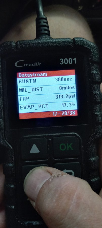

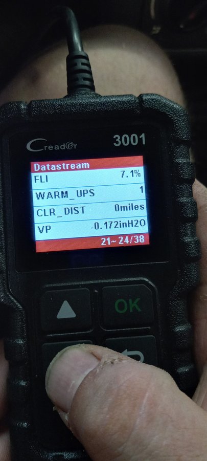

So im turning to the community on this one... 2008 turbo ss, zzp stage 1 tune on 93, 3 bar maps, zzp catless downpipe, it has been a bit finicky since spring rolled around, kinda popping in heavy throttle, but i put fresh gas in it and it stopped, also noted some extra loud lifter tick on startup every once and a while but that goes away quikly like it should, the other day i was driving some backroads and went wot in second at about 2500 rpm and she went like hell for a moment and had a light pop so i lifted. Cruised for a sec and noticed the car had no juice, boost goes from negative to zero, and shes about as as gutless as it gets, got to my friends house and checked all the charge pipes making sure theyre attached, and they were on and holding up, mind you it popped no codes and ran slightly rough, took it for a short 10mile drive and about 8 miles in it finally kicked the engine light, so i got to my destination the harbor freight parkinglot checked the codes and it was a p0101 mass airflow code, i cleared the code and the car would turnover, start, and immediately die if i feathered the gas it would rev up but itnwould eventually just stall out..so i ran live data on it and there was no fluctuation in the reading on the MAF... I unplugged the MAF and the car started and ran, i gently drove it home. Ordered a new MAF got it today, i installed it properly, tried starting the car and same symptoms, starts and stalls out, rev it for a few seconds if i can catch it and it idled like crap but atleast idled, now it pops 3 codes p0100 p0101 and a p0114 all are MAF related.. but still no power, no boost. but whenrunning live data i do see fluctuation so i know it had a reading, and ive tried a known working MAF, ive been going thru it and not finding a problem, maf checks out as good, tried another pcm, still ***** itself out unless the MAF is unplugged.. i took the loom off the harness between MAF and pcm and all looks okay, and then lastnight i unplugged the MAP sensor on the manifold and the boost gauge spiked to 30 but the car wouldnt run.. i figure if it was a boost leak it would atleast make some boost, but that isnt the case here, everything looks good on inspection... gonna try cleaning the cam position sensor, maybe its not reading well but the car is ok with it?? Maybe throttle position sensor? Im lost. Everything reads "normal" with live data... anyone have any ideas? I will post data pics when i get service
