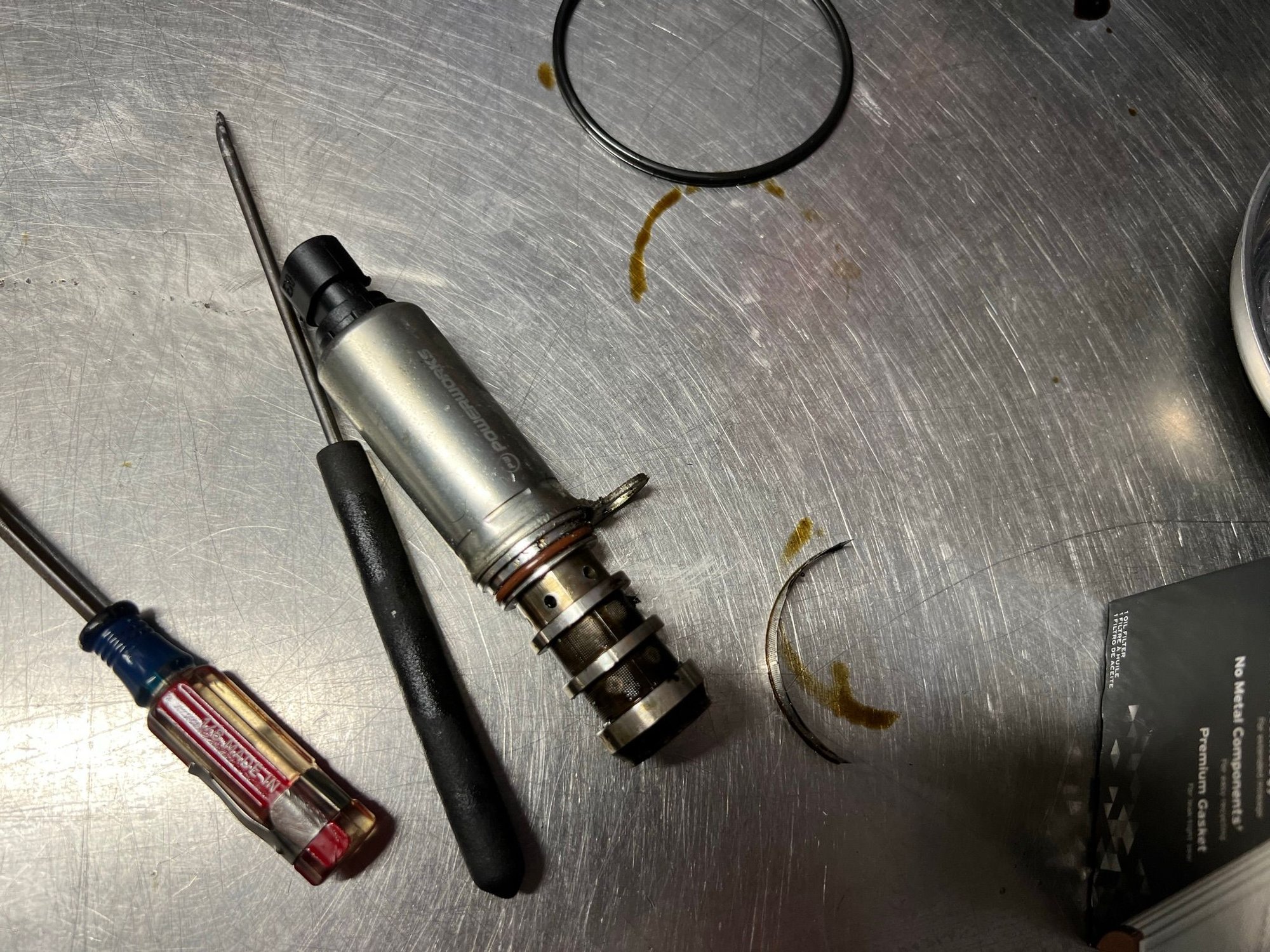

When I removed the old shitty one that was installed on the car, the top screen on the exhaust actuator was completely off… I did flush the oil with AMSOil OE and PuralatorBOSS filter when doing the change.

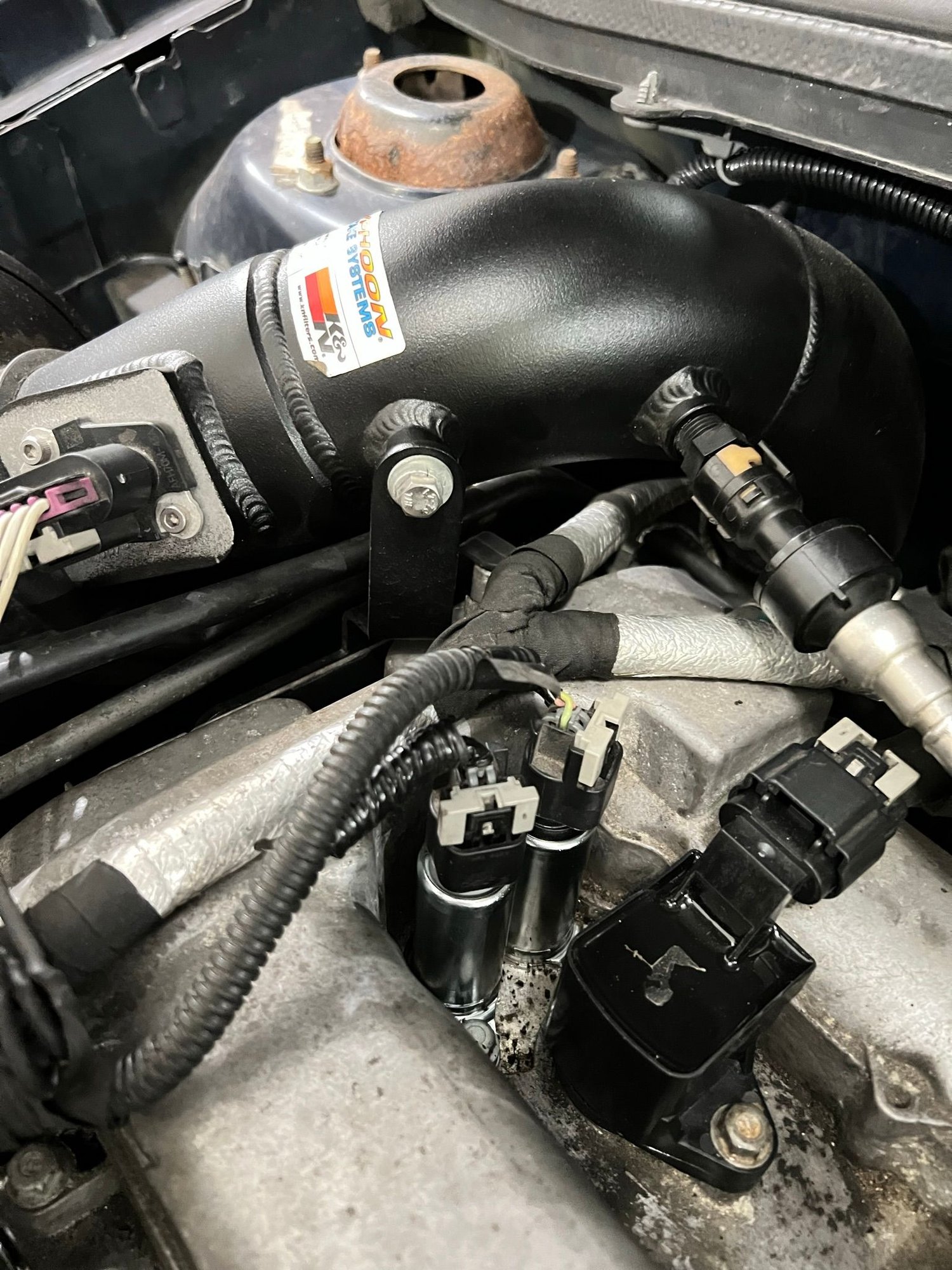

Also, black tipped actuator closest towards the firewall and grey tipped closest towards intake…
Destroyed actuator

Ok,they're installed correctly and connections don't look crossed. You might want to remove and inspect the new ones just to see if more junk got caught in the screen, you can clean it off with carb/maf cleaner and reinstall.
Couple other questions from the pictures
1. I see a K&N intake, when was the last time you cleaned the filter and MAF?
2. I see the MAF wiring indicating the wiring was replaced at one point, I would check the wiring to be sure there is no corrosion at the connection point
3. The PVC line into the intake barb looks like the clip is broken, is the fitting lose on the barb? That could be a source of a small leak that would cause cold start issues but smooth out once going to closed loop, also it wouldn't impact your ability to make boost.

I’ll give that a go tonight! Agreed on how strange that I’m still getting the cam codes… would not oiling the top gasket cause an issue? Maybe I forgot to do that.
1. Never on both… I do have a new drop in K&N filter and can clean the MAF.
2. I never replaced the wiring, but the previous owner may have? I bought the car with 30k miles back in 2017. It has 85k now.
3. I haven’t messed with anything in the bay, in quite some time but maybe I hit a pothole and it came loose. Will check!

Depending on the miles on the filter that could be causing some issues, certainly change the filter and clean the MAF.
The mods with the tune can be adding to the idle struggles, but it shouldn't have a significant impact if the filter is oriented correctly. I forget the orientation, but there is a thread around here about the K&N intake and filter rotation.
The wires to the MAF being white indicates it's been replaced, the one from the factory is color coded. The GM replacement pigtail is all white wires, so the previous owner probably had some issues with the MAF and it was replaced.

So… K&N intake was disconnected at turbo inlet / hanging on by a thread.
