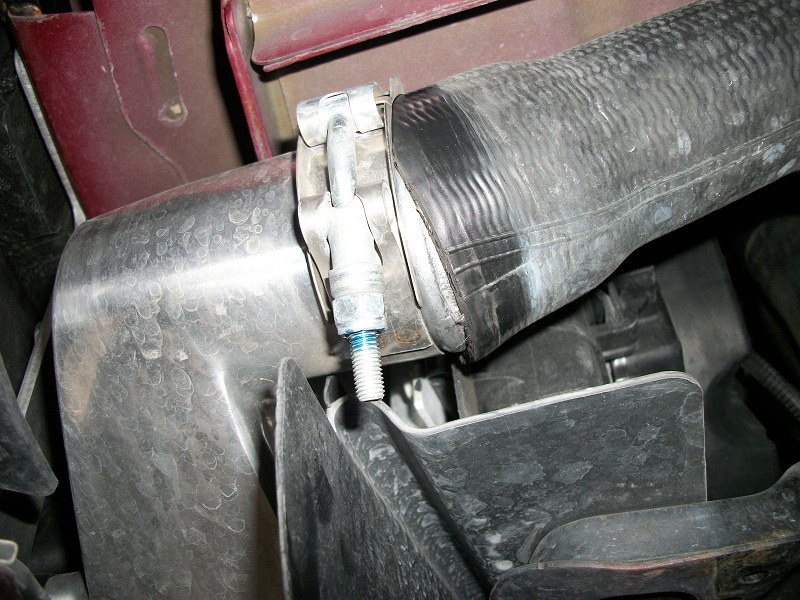

You popped a hose off if you're not even getting past 0. A cracked intercooler usually results in some boost. 0 means you cannot build pressure at all. If your intercooler has a MASSIVE hole, then yes, you would end up with 0, but more than likely, it's just a hose. A 10 minute fix.

It'll probably look like this:

Problem solved ^ this and replaced MAF sensor
