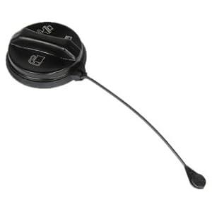

Fuel Tank Cap - ACDelco GT283

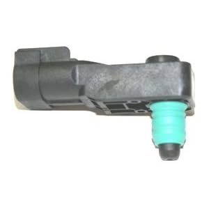

I'm thinking of replacing the Fuel Tank Pressure Sensor - ACDelco 13502903 next,
but would love to hear from someone on this...

There's an evap pressure sensor on the side of the charcoal canister behind the fuel tank. Based on what the code is saying, it would seem that it could be that.
I believe the one I'm thinking of that goes in the side of the canister is the same one you posted up actually. At least it looks to be, based on what I can tell on part diagrams.

This is a sensor located under the hood.. Doesnt cause any change in performance

That's incorrect. The MAP sensor you're thinking of doesn't have that green rubber seal, has a different part number, and also goes in the IM. This is the fuel tank pressure sensor (also a pressure sensor, like the MAP/TMAP sensors) that connects into the evap charcoal canister (#24 in the diagram).

i replaced the pressure sensor n it got rid of it for anyone else with this code :P
