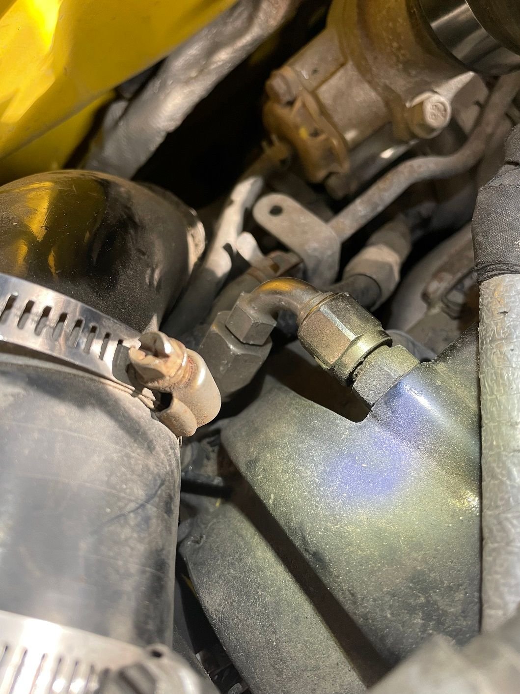

Please help
I just picked up an 08 LNF, and it had this catch can in the trunk. I did post on a facebook group looking for help identifying it, and I was told this was a Powell Oil Separator v3, but got no help as far as install is concerned.
Under the hood, it looks like there is a line coming up from the dipstick and just goes to nowhere. I don't know what else I am missing, or where to mount this. Does anyone have an install sheet or a photo of one installed? It is a stock intake, if that is any help. I realize this is an old thread, but I am at a loss. Thanks in advance for any help.

Here we go;
The top line has a threaded end that goes to the valve cover - that's the line with the threaded end with a red plastic cover part in your picture;
The other line goes onto the turbo.
Don't mind the dirt (ect), my car has eclipsed 300,000km, and has been a daily driver since I bought it new.
If my memory serves me, the original line from the turbo goes to the valve cover, and this setup essentially goes in place of that line - and introduced a drain that goes to the dip stick tube.
This first picture is the ecotec lifting bracket (which I believe was NEVER installed on an LNF engine);
I have the bracket installed correctly here - it uses pretty standard 13mm bolts - you don't need this bracket, but I am pointing it out because I have it in the spot you need to use to mount this oil catch can.
This is that same bracket location with the Powell oil catch can mounted.
Now, this may seem like a cluttered picture, but i am actually focused on the bolt that is holding the line on the turbo (black end with the blue o-ring in your picture).
This is the end that connects to the valve cover.
If my memory serves me, I had to remove the valve cover (don't worry there is a reusable rubber gasket there) and tap this hole for the oil line.

So, does your set-up also have the elbow on the bottom of the catch can, that I assume connects to the line coming from the dipstick?
Looks like I might be missing the fitting that goes into the valve cover...

I can see that you have the fitting for the vale cover:
/\/\ it's the part with the red cap.
That elbow on the bottom of the catch can is where the line that is connected to your dip stick tube connects.
Old Sep 22, 2023 | 04:22 PM

As for the bottom of the can, its like I have two of the same fittings. Probably need a female to female union?
