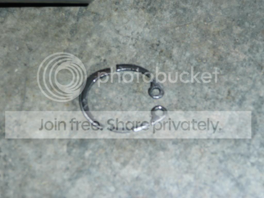

well everything was good. Last night the car started making a funny slapping/ticking noise. Today I went and bought a new timing chain tensioner and pulled the old one out. It was blown apart inside the motor, thankfully only the c-clip actually fell into the motor, the rest fell apart as I was pulling it out. Crazy thing is that was a brand new one when I put it in. Now I am in the process of pulling the front cover, I think that's where the c-clip will be. Wish me luck lol.

Well I found two little pieces of a clip lol. Prolly drain the oil and maybe pull the pan to get as much as I can. Unfortunatly it will be a couple days before I can get back on it.

Found the whole clip. It wasnt easy, but at least I know it is all out of there.

Geesh

damn o well at least its not big $$
