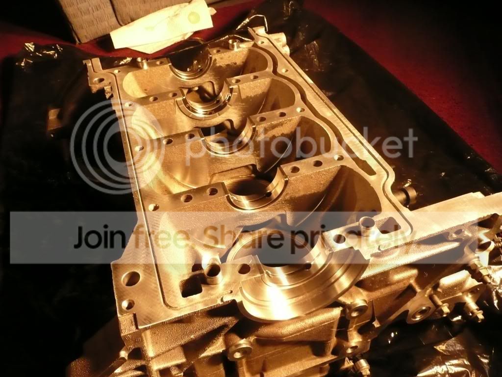

Made some progress tonight. Got the bottom end together.

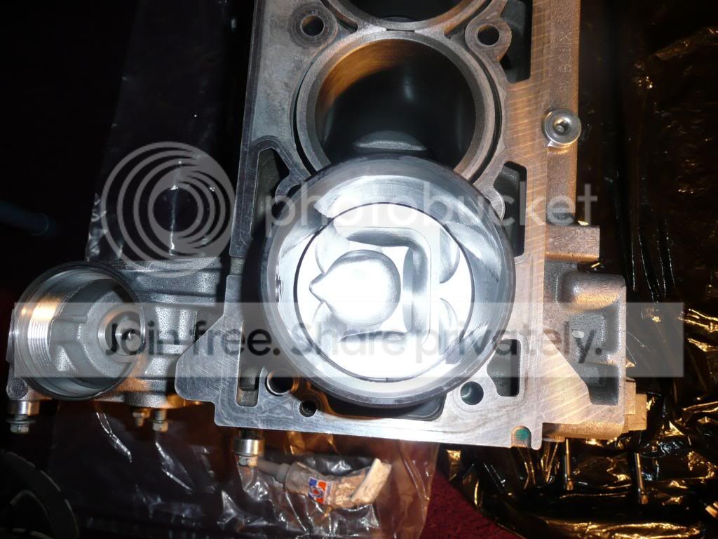

The heads back on and torqued down.

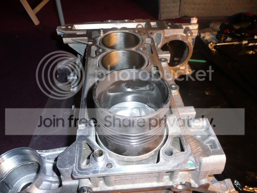

By the way anyone going to do a build, buy the arp piston ring compressor like pictured. The one pictured is the gm one but it make life way easy. It is tappered so it compresses the rings as it goes and then just slips into the cylinder like butter. Way awsome
