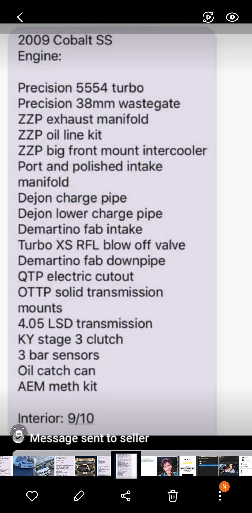

These are most of the mods it has to if that helps

Also previous owner said it had a demartino fab downpipe and demartino fab cold air intake. Who makes that? I can't find them anywhere online
