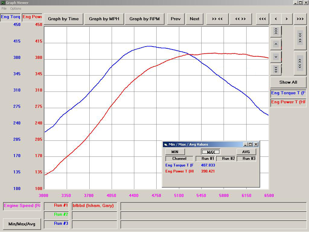

Looks like the WR-2 makes pretty good power to me
93 oct, 23psi made 390/408 on a mustang dyno through a Kappa drivetrain:
New Product - WERKSracing WR-2 LNF Bolt On 450hp Turbocharger!!! - Pontiac Solstice Forum
Not bad
Old Aug 24, 2012 | 04:37 PM
  #350
Dart_SI's Avatar
Joined: 11-15-09
Posts: 7,170
From: kansas
oh my.
WR2 dyno

well i am going to keep an eye on that too.
