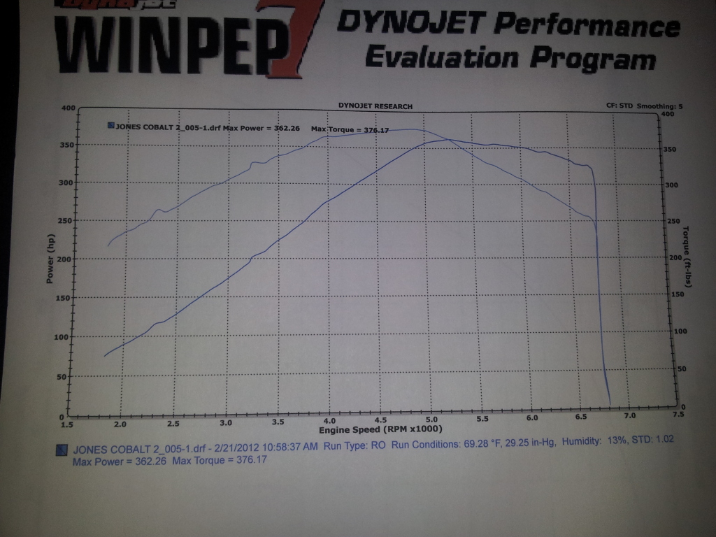

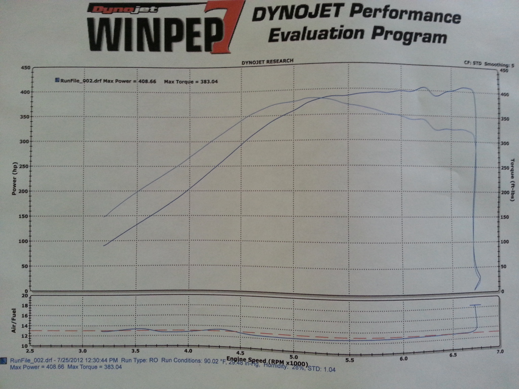

I wanted to give a good comparison of the K04 vs the BNR2871...
My car put down 362/376 on the stock K04 with the exact same boost, timing and fuel as I have the BNR2871 on. The BNR made 408/383 (not sure why I seem to make less peak torque than most but maybe its the way James has me setup. He'll have to fill in on that one). Thats 46whp over the stock turbo. Not bad in my opinion!
Stock
BNR2871

your peak tq comes on almost 1000rpm later than mine. but james likes to do smooth boost ramps, so that could be why. i like my torque.
I guess my response would be...
I like my trans
I did bust one already too. Haha!
