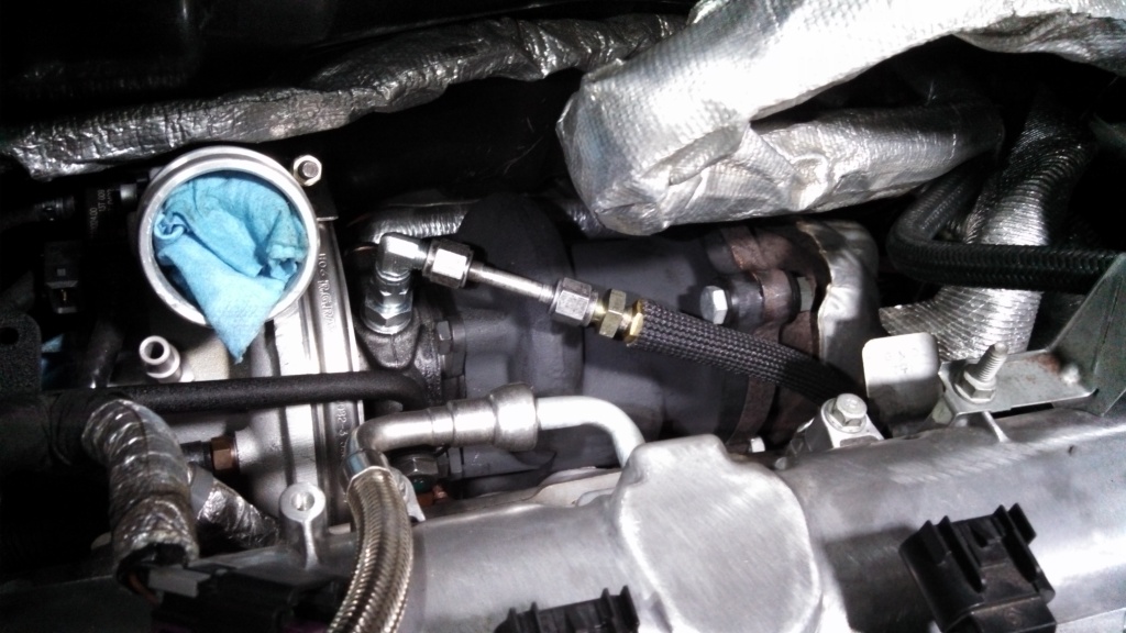

Oh no no, they unfortunately most certainly do not. I wouldn't have said something about it if it wasn't the case. I'm also not the first to have a bit of a fitment issue with the oil feed. Maybe you were somehow fortunate and the line you were supplied with fit with enough slack, or maybe you were content with forcing yours to work somehow.... I'm not. I of course can't speak for everyone who has had this kit, because there obviously seems to be plenty of folks who have had no issues installing the line. I personally sort of question this a bit considering that I would assume all of the lines they made up for this kit are the same length. Makes me wonder how many were forced on and are potential future issues.
Anyways, here's the simple fix on how I dealt with mine. I got a -4 AN male/male adaptor, 2 -4 AN female fittings and cut a small 2" section of 5/16" stainless brake line (it was actually more likely 1/4" considering it was a -4 fitting. It was just scrap I had laying around the shop so I forget exactly.. lol) Flared the ends and called it a day. Now the line has just enough slack in it for me to consider it safe.
