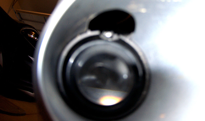

is the hole that was cut into the inlet tube. was that like a way that it would work as a ram air
That hole is there from cutting the bracket piece off

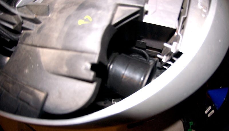

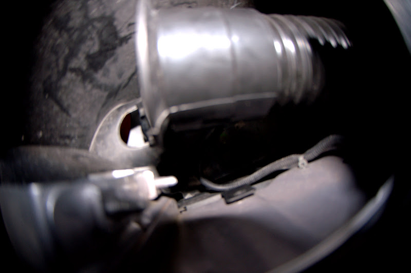

Well its not a ram air deal so to say, but it keeps my intake temps closer to ambient than my Hahn CAI got.
here are the pics:
I cut the velocity stock off and mounted it to a flexible 3 1/4'' tube that I connected to the Airbox. I did have the tube connected to my fog light hole, but I missed having two foglights (-= so I just mounted it above the fog light.
