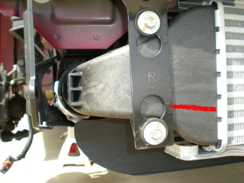

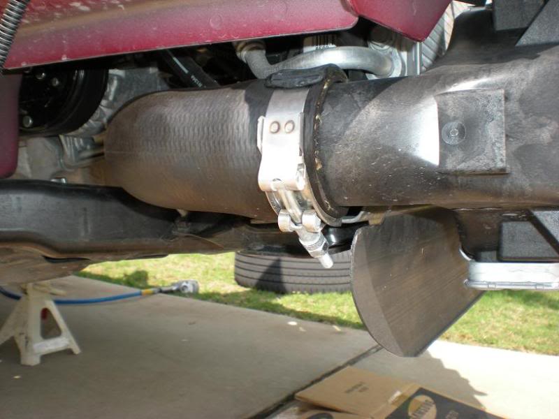

Louee, you need to learn to do the most common test associated with a turbo car: the boost leak test. See my sig. You'll need a source of compressed air, though.
Until you get that going, you can try a visual check of all of your piping and the intercooler. It sounds like you just popped a pipe out of the clamp when you let off the gas. It is very hard to detect a boost leak visually, though. It might look something like this:
If you remove the splash guards around the intercooler end-tanks, it makes it easier to see. You'll get a view like this:
If you take off your bumper cover, you will get the best view of everything. If your intercooler cracked on you, it probably cracked here:
