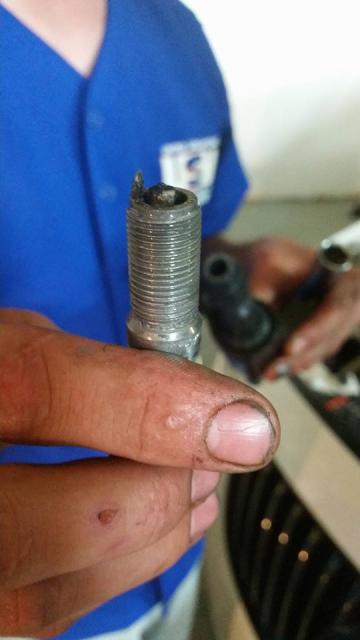

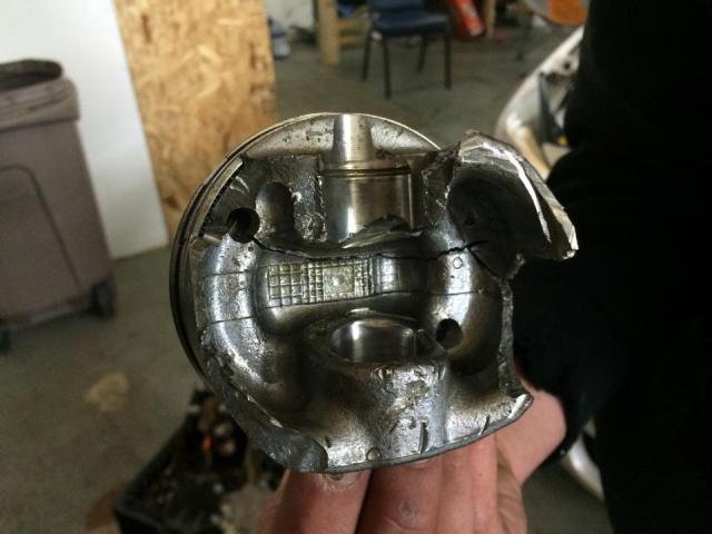

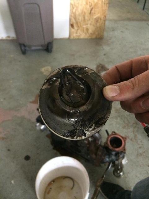

How are the ring lands on that particular piston?

I'll get more pictures of it up today. .. i did notice around every piston there was a cleaner ring around the outsides of them towards the piston walls, not sure if that's normal. Tne rings broke, but one was holding it together.
