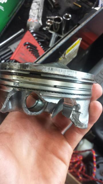

Originally Posted by ItalianJoe1
How are the ring lands on that particular piston?

Does that picture tell anything?
Yep it does. It tells you that the tune killed your engine. Nothing else. The tune. Period. The End.
It amazes me that you guys are still throwing money at vendors that either don't know or don't care.

I'm sorry, I was wrong. It wasn't ONLY the tune, stupidity had a huge part in it too.
Quote from the owner of the car...
it smokes when I let off the throttle (same day I left ZZP). He told me don't worry about it and drive the damn car. I would sit at a stop sign and it looked like someone tossed a freaking smoke bomb under my car intermittently... obviously something not right. ZZP stated I might need a catch can, but really showed no other interest in what it may be- nor said to bring it by to be checked out (these blocks can hold 500whp, remember??).
The next day I do a couple highway pulls and boom, my car is engulfed in flames and throws a rod out the back of the block
Are you people insane? Here's what happened. You broke a piston by overheating the rings and breaking a ring land. You then proceeded to keep driving it and doing "Highway pulls". That fractured piston could not handle that and came apart. Broken piston pieces don't compress very easily so the rod also exploded and destroyed everything else.
All you had to do was STOP DRIVING IT when it was belching smoke and all you would be doing right now is throwing some pistons in it.
Really? This is a big mystery? Horrible vendor+bad parts+horrible tune+stupidity=shrapnel. This stuff is utterly amazing to me.

Wait a minute. I just re-read the owners post about what happened. He picks up the car from ZZP and it's smoking on the way home? Holy cr@p, they did a dyno run didn't they? ZZP BROKE THAT ENGINE ON THE DYNO!!!!!!!!!!! They pushed it too far on a cr@ppy tune and cracked the piston. That was why it was smoking on his way home from ZZP. Again, the cracked piston finally failed catastrophically after "a couple highway pulls".
I wasn't there, but the way it's described, it sure looks like ZZP broke this motor on the dyno and just let the guy pick it up and drive it home. Holy f'ing cr@p! Tell me I'm wrong in my reading of this guys. Sure seems to me it's pretty simple to understand what happened. No wonder they didn't give him any dyno sheets!!! Infriggincredible.

Look call it stupidity all you want that's why I am on this forum, i dont know anything about these cars... hell everything I did read was that a direct inject turbo car burned oil normally so a catch can was necessary. I honestly thought tne extra rpm just had more vacuume in the casing or something.
Doesn't zzp safely tune cars?
I'm more upset about Zzp calling me back a week later and saying they didn't get my email (are you f'ing kidding me I see it confirmed in my sent folder) he states he just got the voice mail a week later and there's nothing he could do so he didn't call back right away. I'm not one to ever negatively critique a shop, but dear lord, zzp Even admitted that he smelt oil on my test drive, then gave me my freaking car back to drive home. I'm a police officer I've seem my fair share of bad accidents, but I am truly blessed I didn't lose my damn life due to zzps negligence. seems they were quick to take my cash but when it came time for them to sac up they won't help me out at all. Kind of sucks, ib may just cut my loses and trade it in once this motor goes in...
You really want to know the kicker of it all? Zzp called me back a week later, lies and says they didn't get my email (are you f'ing kidding me I see it confirmed in my sent folder) he states he just got the voice mail a week later and there's nothing he could do so he didn't call back right away. I'm not one to ever negatively critique a shop, but dear lord, zzp Even admitted that he smelt oil on my test drive, then gave me my freaking car back to drive home. I'm a police officer I've seem my fair share of bad accidents, but I am truly blessed I didn't lose my damn life due to zzps negligence. Be forewarned, they were quick to take my cash but when it came time for them to sac up they ran.
Just for your info, the EFR (before zzp puts their exhaust housing on it) has a double sealed bearing cartridge specifically to address the oil consumption from traditionally built turbos. Check out their youtube vid about the EFR some damn interesting tech went into them
I've seen it, but people still blow the zfr so I didn't bet against it.
Early efr's had an issue, they released an updated version shortly after the initial
