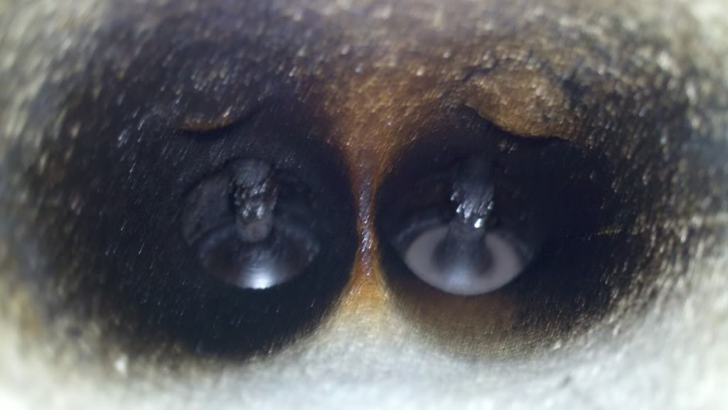

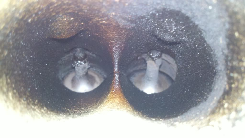

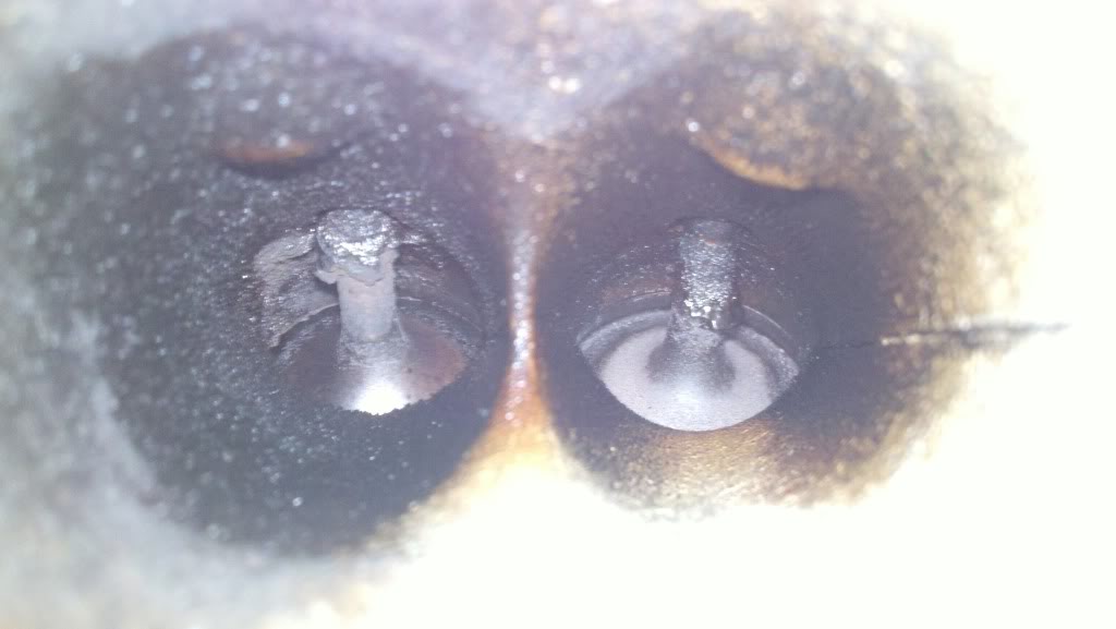

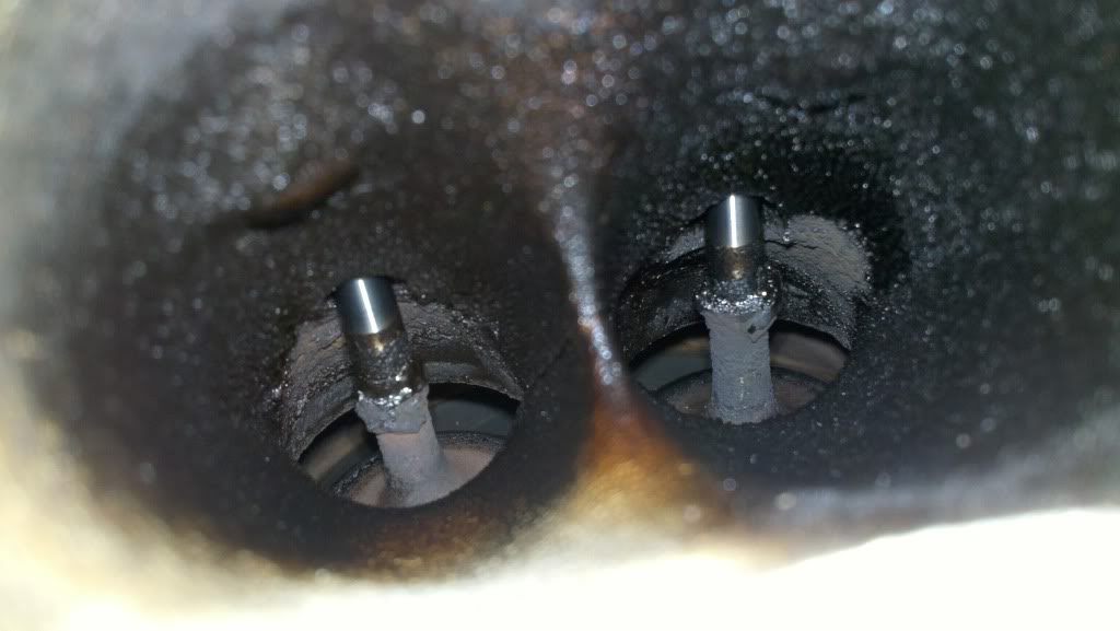

i just pulled my IM today because I had to replace my injector seals and figured I'd post up pictures of my valves and what I've used in terms of maintenance for reference for others
Bought the car with 40k on it and unknown previous maintenance records
Mobil1 synthetic changed every 3000 miles
seafoamed every 6000 miles
I drive the car like a raped ape most of the time, so its never really babied around except while cruising on the hwy
ran on stock tune from 40-50k miles. HPtuned on 93 from 50-58k miles, HPtuned on E47 from 58k-current 61k miles
from cylinders 1-4
overall, after seeing some of the posts in here I was expecting to see much worse.. that said, I still know mine arent great. Regardless, I just needed the car running so I didnt do anything to them for now. I will be cleaning them this fall once the car has a bit of downtime where I can just take my time with it and clean them right.
