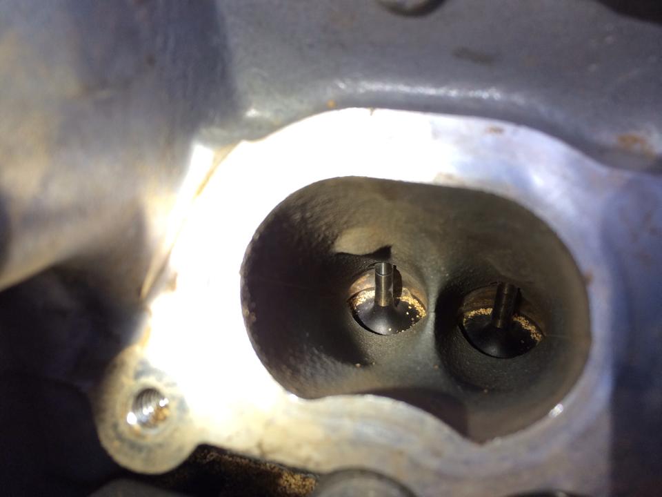

Decided out of the blue today to take a look at my valves after my poorly done hand job at 50k km's last summer. It just so happens a local group member bought some media and an air gun and two buds where already doing there's when I showed up at the vancity garage. Once done they looked pretty good, blasting took all of 15 minutes, while hitting them with a pick set took a good hour+ for all the hard buildup.
Total job time 3 hours with lots of comments from the peanut gallery

did you replace the pcv with a new valve? If not you are getting good at this put one in. lol
No
My plan was to upgrade to your system before the valves get nasty again(as in soon). Or should I replace it when I put the separator on?

I would recommend make sure it works. hard to do when the IM is on the car.
Krispy I wish I could take such nice pictures of the valves. How about some "clean" pics? lol
