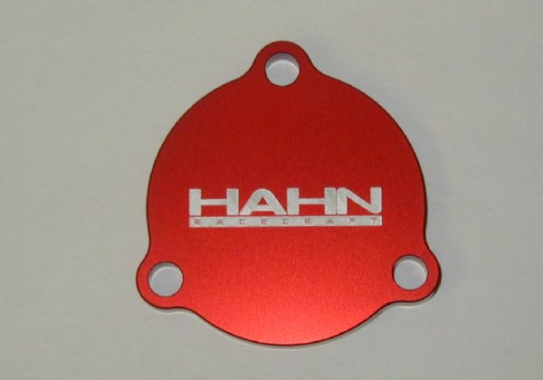

Originally Posted by kling1022
SO let me get this right. You just put a block off plate on the factory BPV, install the synapse one on your intercooler pipe, Run the vacuum line that was originally on your factory BPV to the new synapse BOV, and that's it right?
I believe that is correct, you would use somthing like this from Hahn:
Link:
http://www.turbotechracing.com/produ...idproduct=5228
