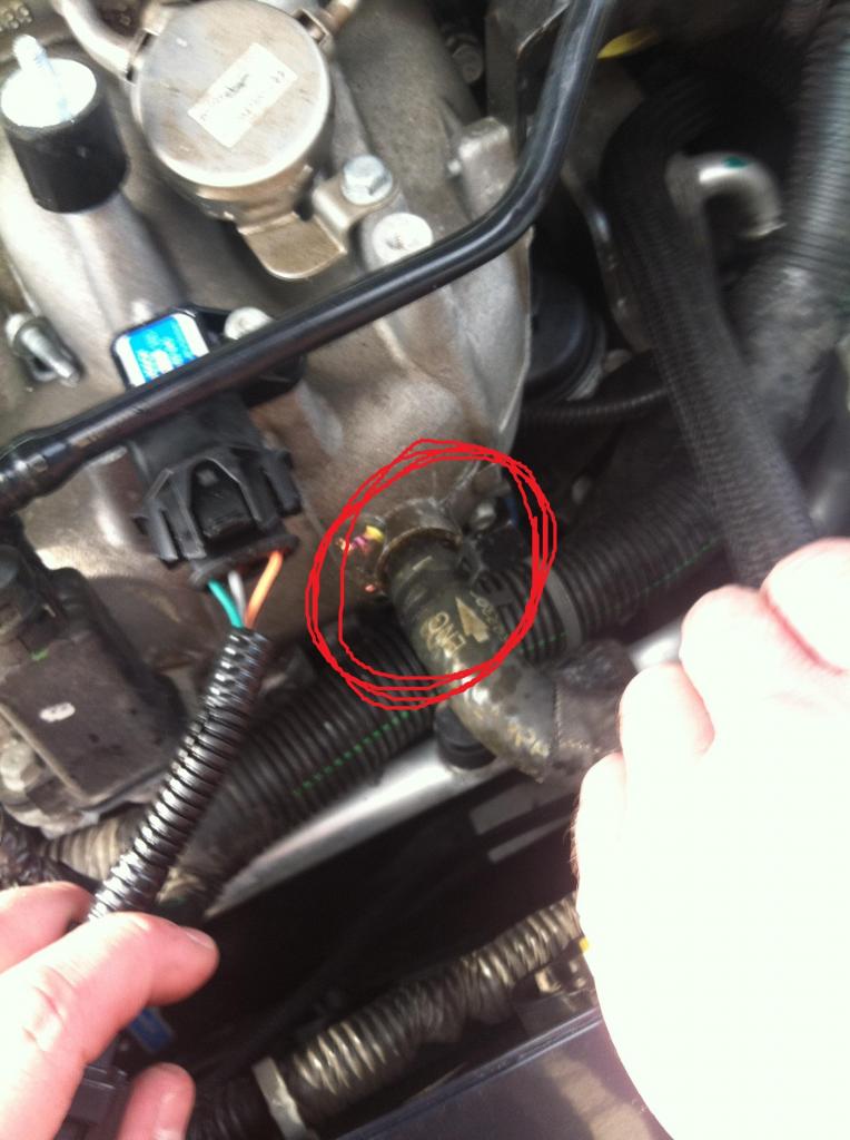

I retightened every pipe, still leaked. I reinstalled my map sensors, still leaked. I than started a boost leak test and it slowly lost boost over time, still leaked. I attempeted the boost leak test 1 last time but just started spraying stuff on the engine bay and not just the pipes and soon as it hit this, it bubbled like crazy. The fitting wasn't even tight at all. I was able to untighten it with my fingers. Threw some teflon tape around it and tighten it up and it was golden.
Here was the line for my issue. Lone and behold...

How was it keaking btw. Was it ripped or kust not on tight enough
Old May 9, 2013 | 10:39 PM
Wert842's Avatar
Joined: 07-12-11
Posts: 4,301
Wasn't tight at all. It somehow got lose. I took the fitting off intake mani with just my fingers cause it was that lose. No idea what caused it to get like that. Weird though.

Omg dude this is ironic as hell. I have been having tuning issues so I put gms1 back on the car because I am on a road trip right now. Well I get 400 miles away and get off the highway last night on a back road and go wot, sputters and falls on its face...checked all tbolt clamps then i hop on the forum this morning...that same fitting is loose on my mani. Never touched that fitting before either. Turned it out with my fingers like you. Hopefully this was contributing to my tuning woes as well.
