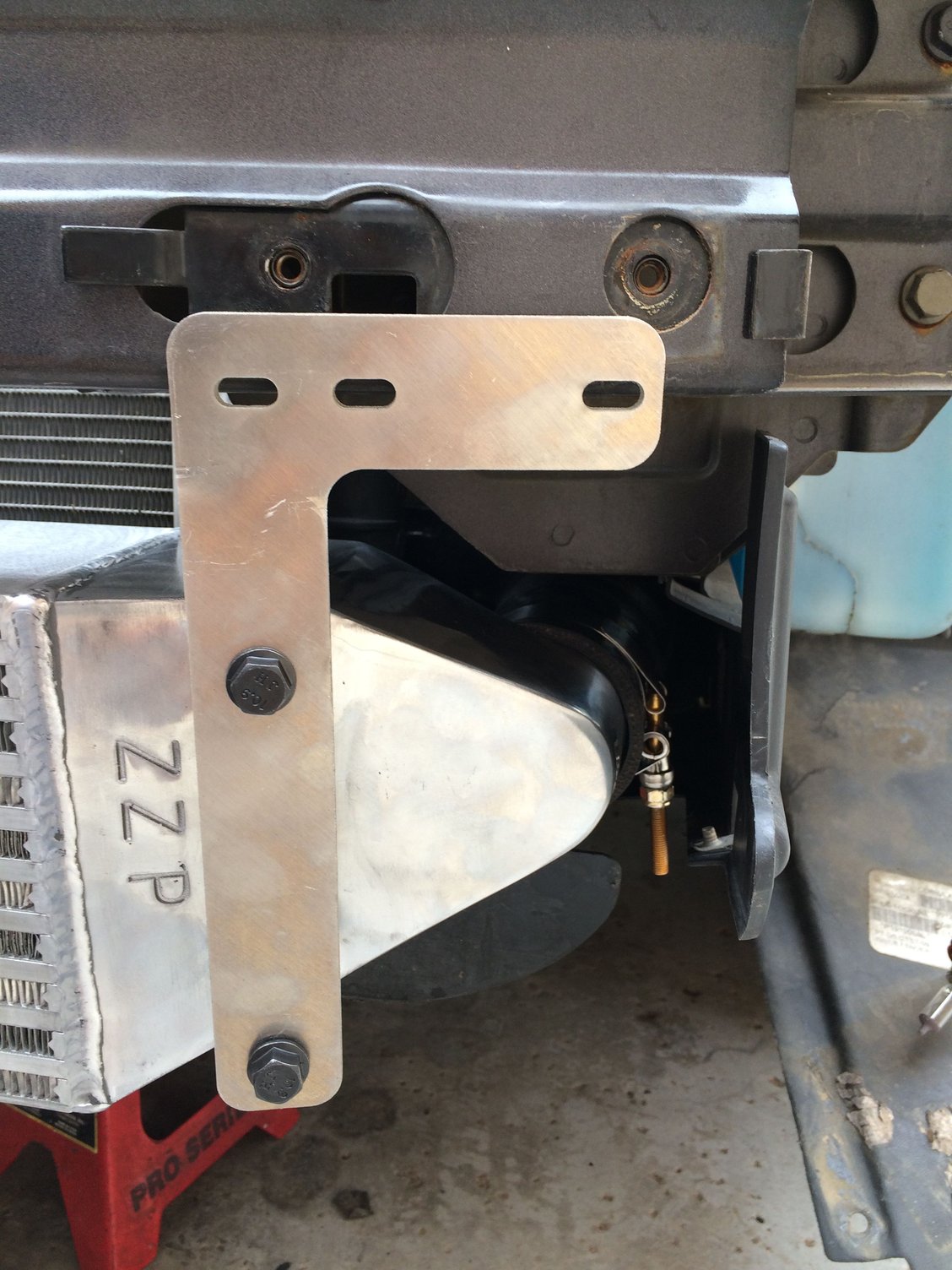

Old Mar 11, 2016 | 07:15 PM
  #48
Jesse09SS's Avatar
Joined: 03-11-16
Posts: 8
From: Surprise AZ
Originally Posted by Matt M
Did you have to drill one new hole in each bracket? I think that's what the extra holes are for. The brackets are interchangeable now.
4 years later I figure we can update the pics of these brackets in question. <br/><br/>They don't reach the Orginal holes. Not long enough to bolt up directly. <br/><br/>New holes had to be drilled to accommodate
Old Mar 12, 2016 | 02:17 PM
  #49
Omiotek's Avatar
Joined: 07-04-10
Posts: 3,262
Likes: 66
From: Carol Stream, IL
Looks like the intercooler can go up higher. Maybe they sent the erong brakets. Did you contact zzp
Old Mar 13, 2016 | 10:02 AM
  #50
Tdubbs's Avatar
Joined: 09-18-15
Posts: 748
Likes: 96
From: Battle Creek, MI
The intercooler looks upside down. I just installed mine, and it fit perfectly, but mine is 180 from the way you have it in the pics.
