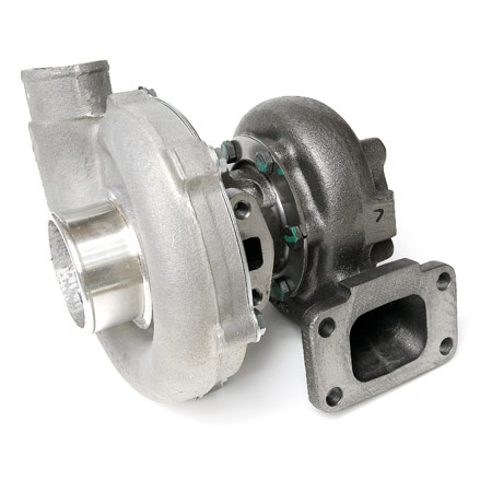

Ok blackss/sc .. if you are going to grab something that will work well and be on the cheaper end of things then go to this turbo....
Turbocharger - Garrett T3/T4E, 50trim compressor, Quick Spooling Stage II wheel with T3, 4 Bolt (2.5") discharge 63AR or 5 bolt Ford style .48 A/R, 400+HP
ATP Turbo --- T3/T4E 50 Trim
Talk to them on internally gating it for you and then go from there.
This will be a $695 dollar turbo new..... or you can go with Denny's suggestion and find a 16G from a DSM guy used and then rebuild it and go from there.
I may be able to get you a discount with ATP by the way since my boy is a ATP dealer.
