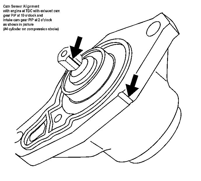

Mines doing the same thing. Ive swapped the cam sensor out done timing on it numerous times. Just bought a new timing set. If that dont work im changing the crank sensor.

From: KY

Done that too numerous times.
