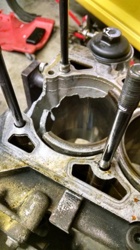

Well I need something good. Yes I will turn it down to start with but knowing myself I'll probably turn it back up. Stock lsj block at 644 equals this

Holy ****.....
I hate to say it but kinda wish there was a vid of that...

Yaaaa no support up top will do that lol. I've done the same just not quite that bad haha. Personally I think a Gen 3 will serve you just fine. But the block is so new that no one has really pushed it to failure. If it even will. But I know a couple guys have done 600+ builds on here with it.

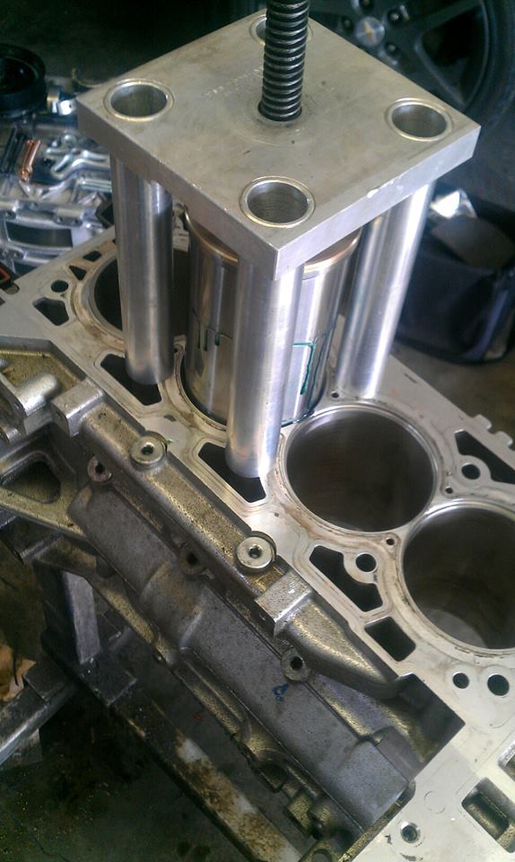

the zzp closed deck went 898whp on stock sleeves and I have resleeved 2 of them so far due to worn out bores but I would not have any problem running a gen3 block and pushing it either but you need to figure out how much hp is enough
you should consider doing a 2.1

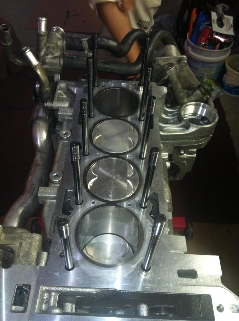

Old Sep 23, 2014 | 12:59 PM
574's Avatar
574
Joined: 11-16-11
Posts: 6,338

Nick, you need to finish your stuff up and get on the dyno! You are a girdled Gen 1 correct?

Old Sep 23, 2014 | 01:42 PM
574's Avatar
574
Joined: 11-16-11
Posts: 6,338
Zzp Gen 1 I believe
