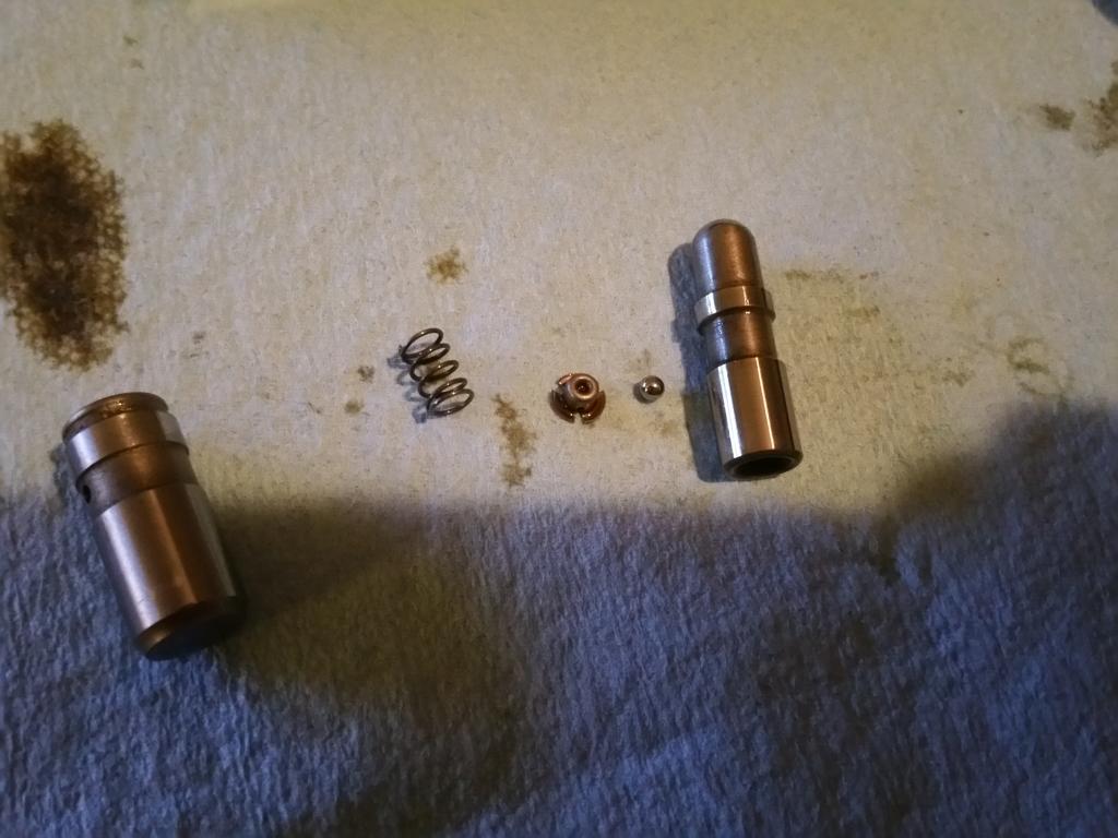

I took one apart and only found this...

just so you and anyone else can see, here is spawnes pictures of a dissassembled last adjuster
thank u.

Our stock lash adjusters bleed down easily. You can do I with a pair of channel locks and moderate pressure.
There is clearance between the body and piston, obviously. Push it hard enough and oil will flow through.
Is that the old design or the new design, because I needed a vice to bleed down the one I disassembled.
