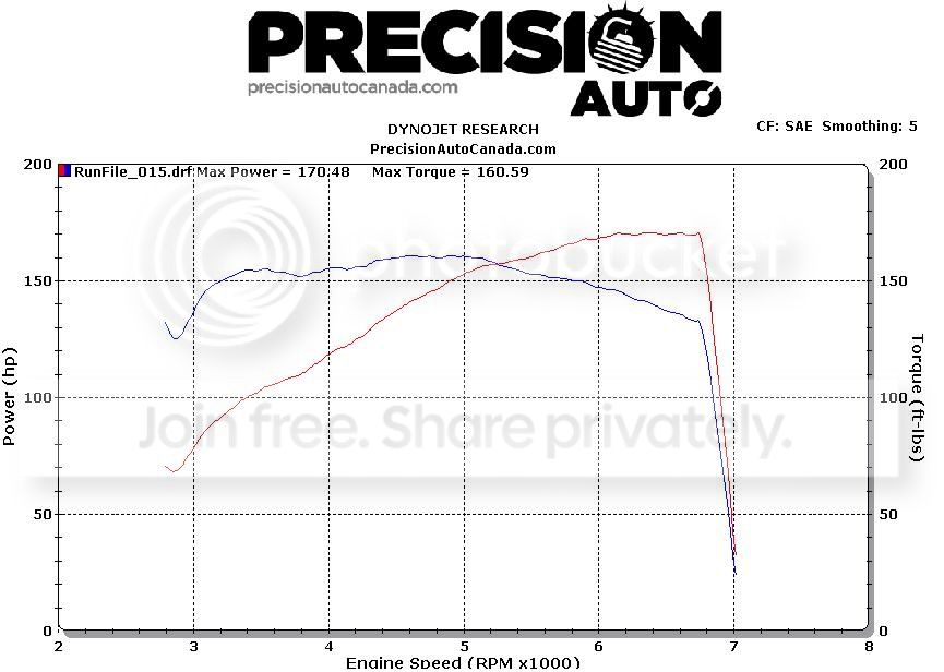

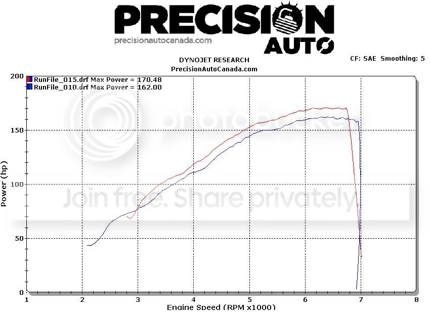

The vibrant realy give a gains HP
Stock with just K&N intake give 162Whp
With 4-2-1Vibrant combo with down pipe give 170whp
8whp of gains for a header it realy good !!
2.4 Tuned with HPtuner 7000Rpm cut off

Originally Posted by D4u2s0t
alot of people have it, doesn't mean it's the best choice for a bolt on 2.2. While it may give a higher peak hp # over stock, it still will not produce as well as a properly sized exhaust, in this case smaller. Though i'm not sure why I'm still trying to explain at this point.
ok you have now the dyno sheet of devilx
.its time to find a other dyno sheet with same mod but with a other header and downpipe.
since we have no number yet to compare. vibrant gives 8whp, its already good and it not just peak hp but all away up.
1) that's a 2.4, not a 2.2
2) when were those taken? Same day, same conditions?
3) he says stock and a k&n was 162, but then a header AND TUNE gave him 170. But, it looks like he was tuned prior to the second run because of where the hp drops off. So he's basically able to take more advantage of the header/dp because of the tune.
1)still n/a
2)suppose it was same condition
3)so a vibrant untuned wont give much hp that he did according to you
i thing that his first pull was tune but stock exhaust. where is the rev limiter on a 2.4? 6500 or 7000. because you can see his first run finish under 7000 but close.
1)still n/a
the thing is, it's not unusual to see a +-5% difference on a dyno, especially if it's on a different day. And you can't compare a 2.2 to a 2.4 in terms of power gains. I'm not saying it's not a good header, I say all the time it's one of the highest quality pieces you can buy. That's not the debate. Fact of the matter is, it will be too big for a bolted 2.2
