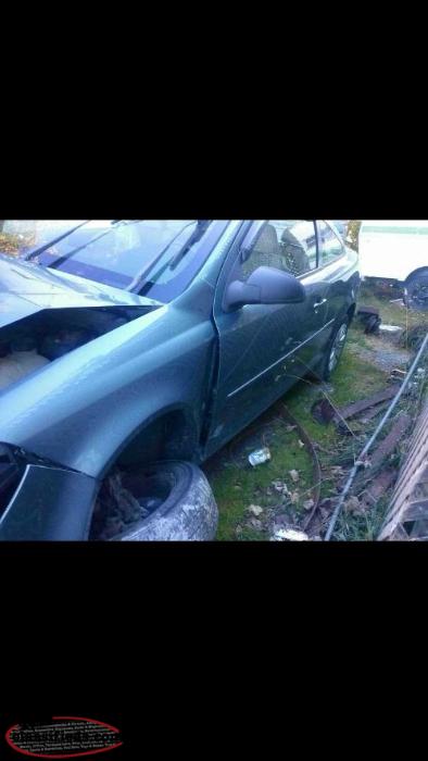

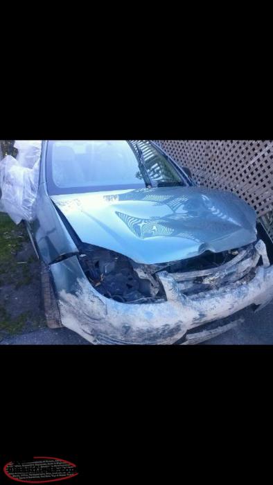

Hi, i have a 09 lap engine cobalt automatic and it been in a accident. The engine in it still has 60,000 miles and i was wondering what other car would go perfect with the swap? There a few pictures of the balt you can view... and is there any advice about what i shouldnt do, any tips would be helpful
