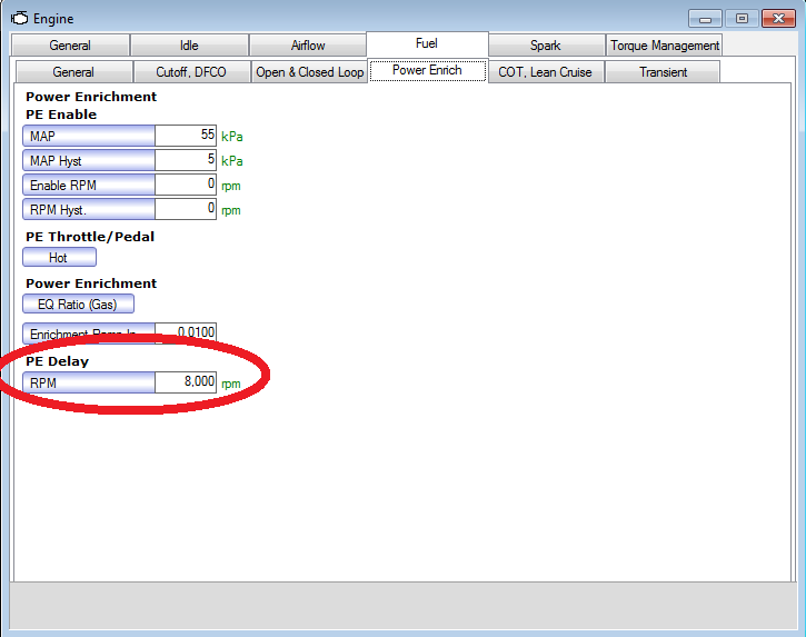

What is the PE delay RPM and enrichment rate stock? Some of the GM trucks had a 4800 RPM PE delay which caused huge power losses at WOT below 4800.

Originally Posted by supernovanator
IMAGE#1
that seems a bit high, I don't even reach 8k.. well its not like I could even if I wanted too.
Posted from Cobaltss.net App for Android
That would make it seem that the car never enters PE unless you reach 8000 RPMs. Strange.
I have two valuable, interesting bits of info to post here. First is a vid I found in another thread and section of this forum. It's a vid of a Trailblazer throttle body with and without a tune for the throttle opening rate. The opening rate is even higher on the Trailblazer than the Cobalt 2.2/2.4 by a good bit, if the info from the vid is correct.
My other bit of info is this: I set my PE delay to 3000rpm and noticed something interesting. While datalogging before messing with the PE, I noticed a considerable KR at .46-.54G/Sec and 3600-4800RPM at various speeds. Around 80mph WOT in 3rd gear, I noticed 4* of knock for several seconds. After setting the PE delay to 3000rpm, I experience no KR whatsoever on a 0-110mph run at WOT, except for maybe .5* KR when shifting into third.
