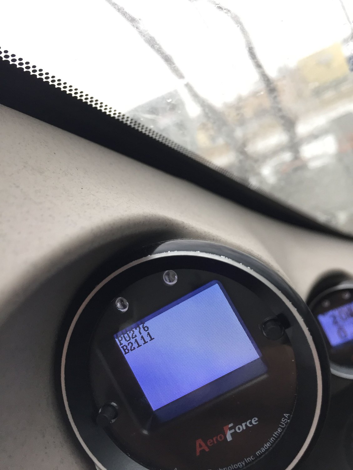

Well in the gauges (interceptors) you can bring up codes, after leaving that screen and going back in it’s usually different codes.
One code is pretty common B2111 which means nothing?
Anyway, going Into hptuners. No codes will be present.
These photos are from a few months back...

I honestly don't even know how the interceptor works. I've only ever checked codes with an OBD II scanner. Like the second picture is P0181 which online looks to be "Fuel Temperature Sensor" I don't even think your car has a fuel temperature sensor. Hopefully someone that knows about the interceptor may chime in about why it seems to bring up random codes.

That’s why I’ve kinda dismissed these as actual codes I believe B2111 comes up as power seat recliner (been a while since I looked it up)
but my model certainly does not have power seats...

most of those codes dont even apply to a cobalt. i would shoot aeroforce an email and ask them whats up.
