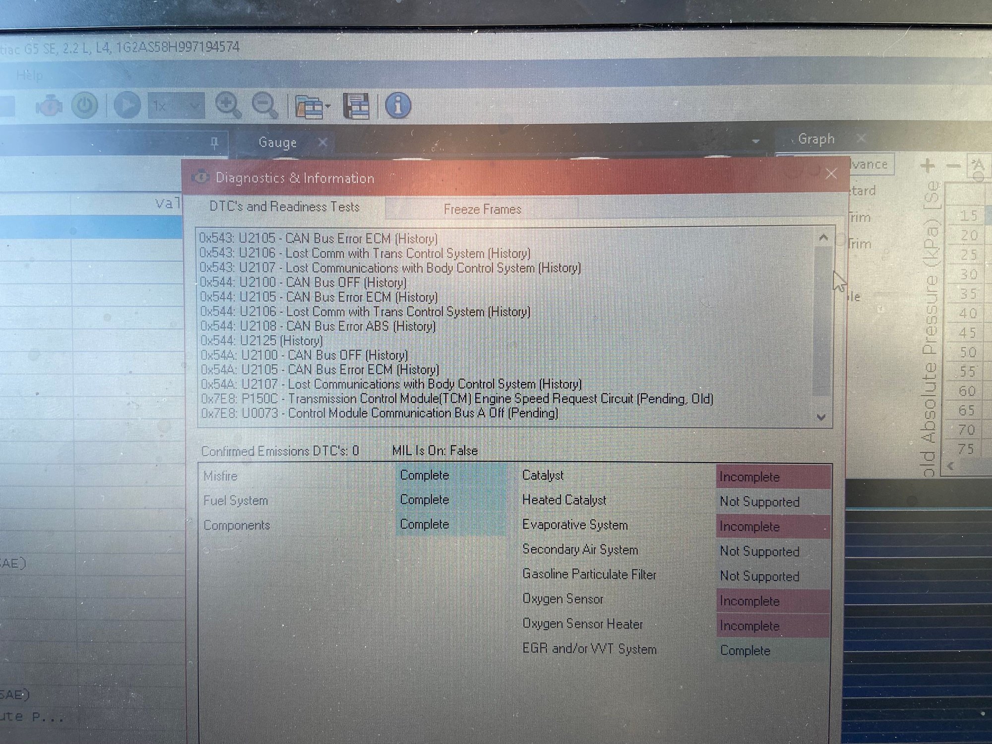

So ECU is 0x7E8
u2108 and u2125 are new
Gonna do some ground work finally tomorrow, should be nice. Kinda looks like it’s the TCM taking the network down since ECU is reporting faults but the TCM did not.

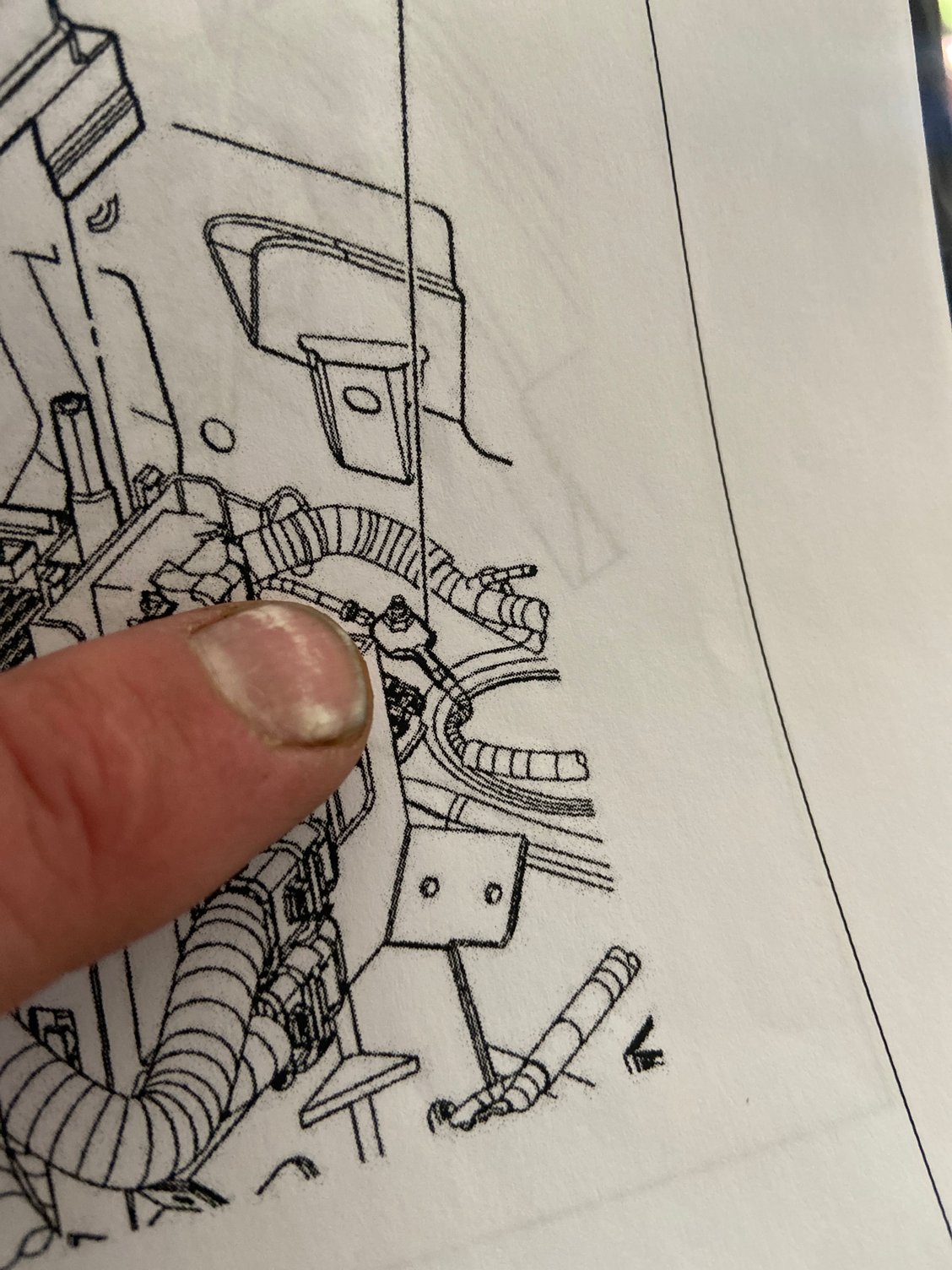

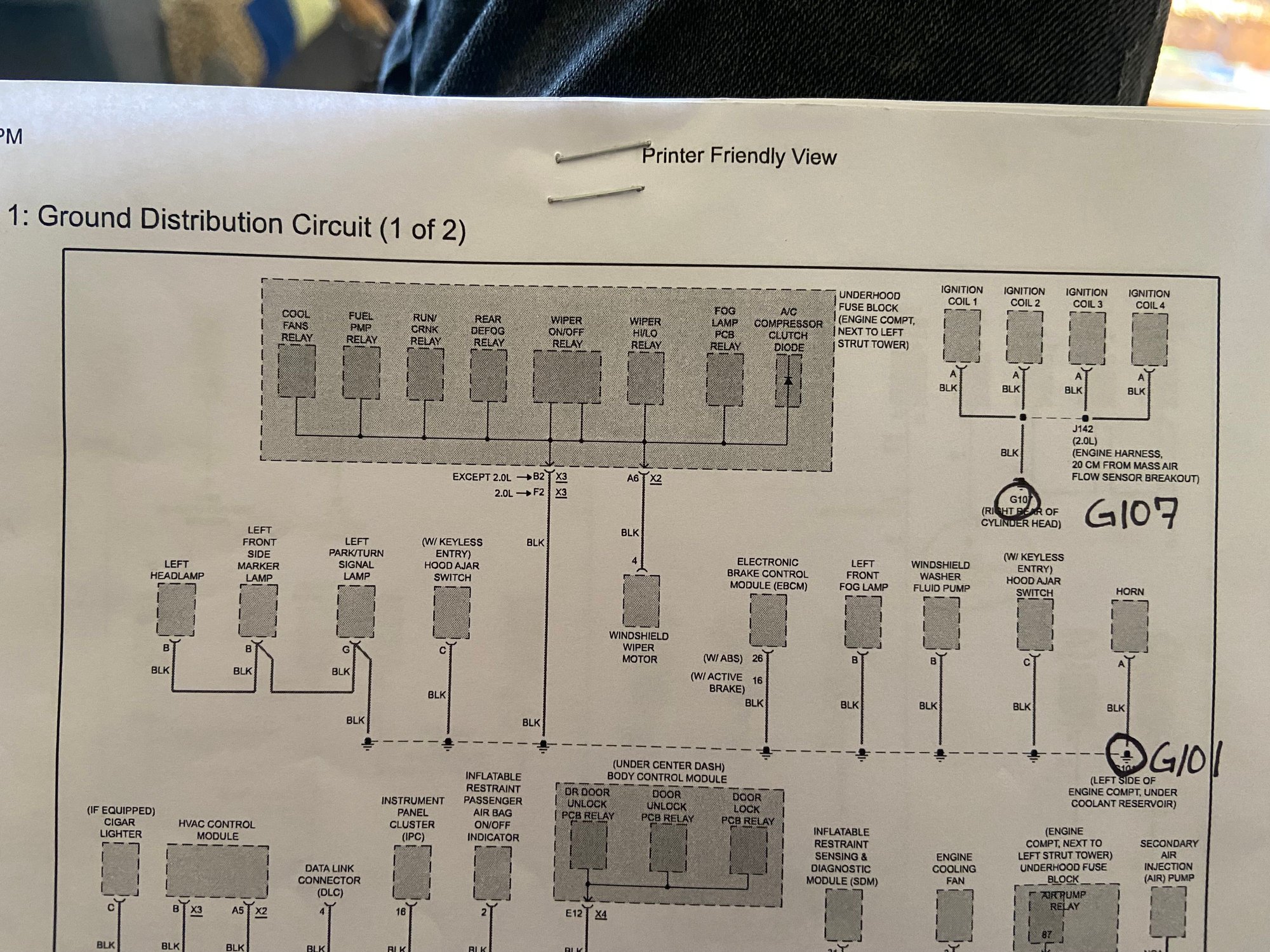

Found a nasty ground under coolant bottle.
im all my research, it looked like there was just one ground under the coolant bottle, as I could only see one. However there was a 2nd ground on the same stud coming from the cowl so it couldn’t be seen till I removed the coolant bottle.
cleaned up negative battery terminal ground. Cleaned engine jump post.
gonna re assemble see if it fixed it

I think the rearward ground at G101, must’ve been PDC.
forward ground at G101 (visible) must’ve been lights/horn etc.
car started! Kinda warm out right now so perhaps not saying much. Gonna bust out the laptop scan for codes and see if I can get it act up
I re routed both ground wires there to new, higher locations so I never have to spend an hour to get to them again lol

U2125 took some effort to clear…
And dlc still seems slightly sensitive..
But that had to be it lmao.
Run/ crank relay was on that ground. I’m surprised it started at all..
