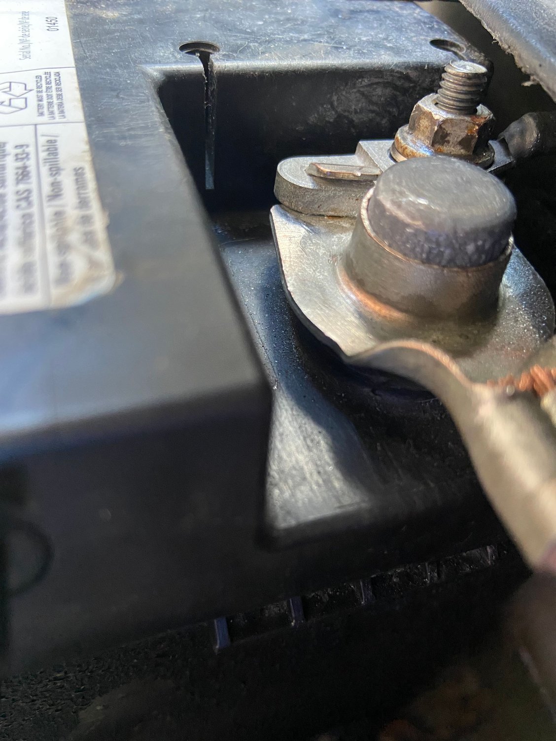

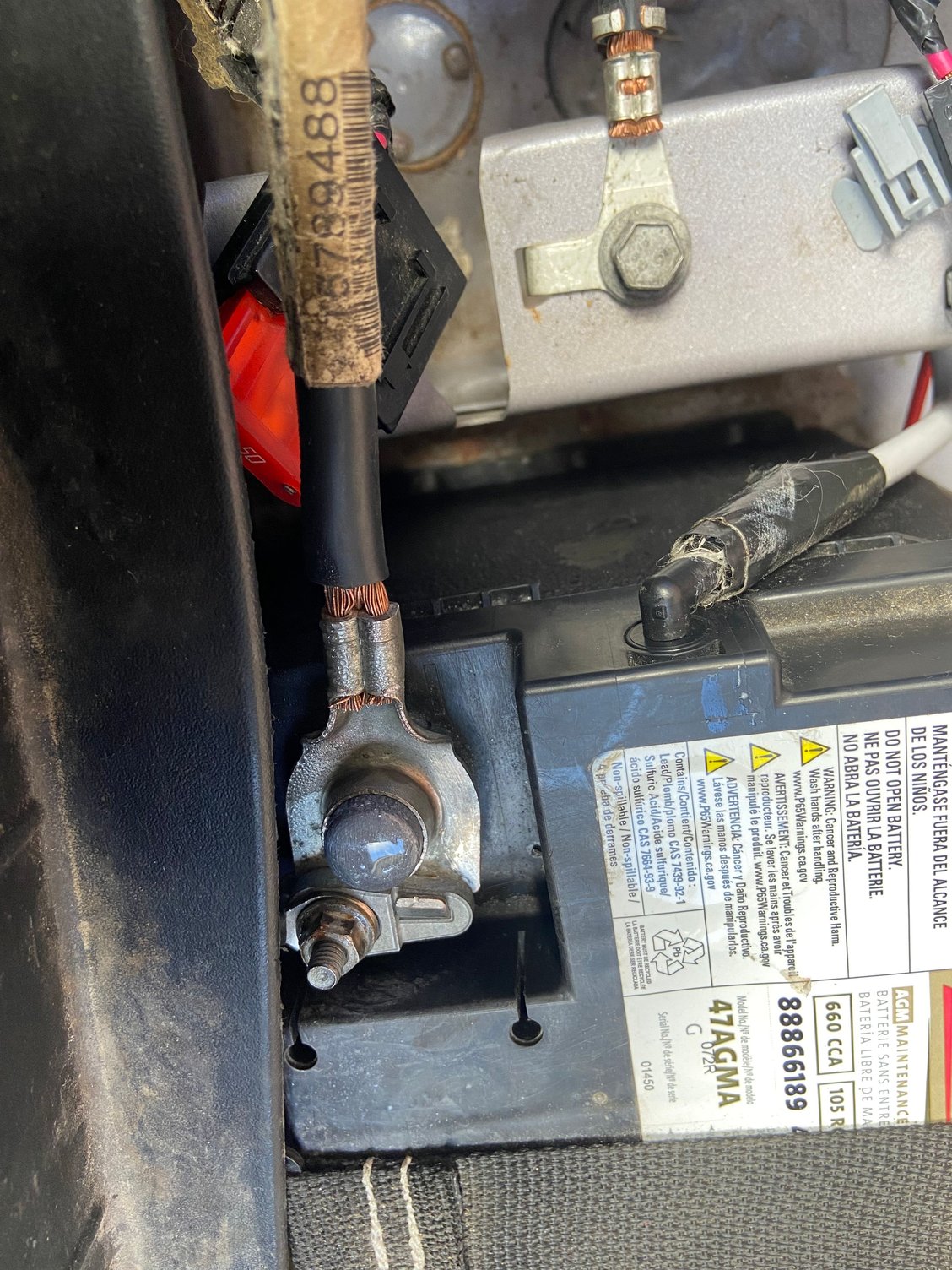

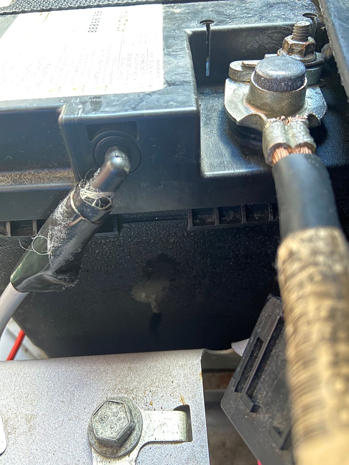

I spent all night yesterday, cleaned positive battery terminal cable between alternator and starter, then starter to PDC.
Re did a few grounds, moved some inside the car. Cleaned battery terminals once again.
I want to pull the connector off the ABS module for U2108, and I suspect, with my rain trays, any water coming off my hood would land in roughly that area.
I'm also gonna go ahead with a new wideband for peace of mind. One of the gauge's lights are burnt out anyway so there's some justification.
What really throws me off here though is, Fuel trims are negative while cruising indicating it wants to pull fuel, yet, it's already running 15-17 AFR. So which is it, narrow bands think it's a little rich, wideband thinks its very lean.
Header and downpipe are at most 2 years old, flex pipe looks brand new, it's got a new v band clamp. it would make sense if there was a leak in-between the two sensors but NILL!

After just one day of sitting. Cleaned th post yesterday was dry as a whistle.
**** maybe com codes are a result of water on battery.
i suppose I can remove my spare 4L jug of methanol, drive it for a while and see what happens.
im just dumb founded. It had a lot of water on the negative post. Touched it and it’s harder to tell now in the photos. Almost want to find a pair of organe gloves see if it turns purple when I touch the “water” confirm it’s not battery acid

I would check for leaks in the trunk then, but otherwise yeah. I don't remember, but the battery is relatively new yes? You could also take it in for a free test just to confirm the cells are still fine. I've had a DOA, and 1 year after it died before.
