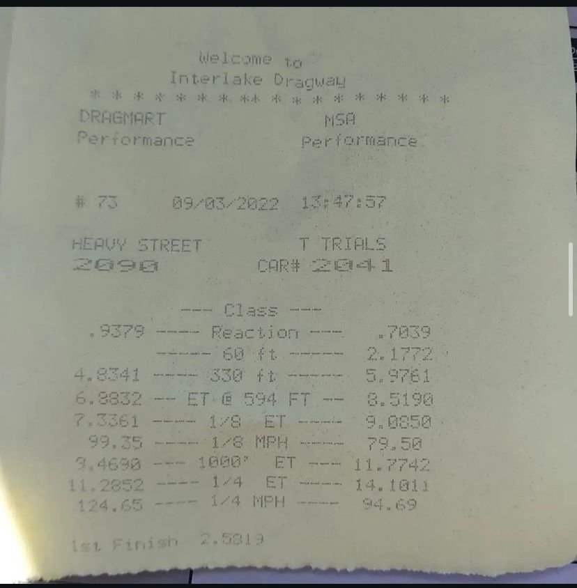

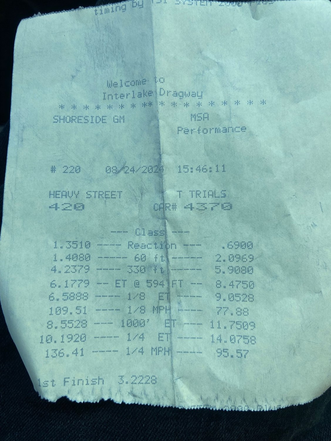

Went drag racing this weekend for the first time in 2 years!
I did not break 13s! (
But it was still a lot of fun.
Spun a little on my best run. It shows in the 1/8 mile km/h.
Nonetheless, really cool to see the car marginally improve.
Was 38C, stupid hot.
I feel like I was one run away from hitting 13s but they closed the track down for Cash days.
I think I need a nice cool day and it will run high 13s.
Ended the day with 23 degrees of timing, shift speed at 7050rpm in 1st and 2nd, launched at 2500rpm.
Not a lick of KR, Trans reduction duration was turned off.
There was another cobalt there with a built turbo motor, he had 100hp on me lol and was running 12.8-14 depending on if he bogged.
I do have a 2.7" pulley and a manifold spacer, would just need to machine my snout, debating it lol.

Every run bumped timing 0.5 degrees and 25rpm shift speed.
At least I walked away with a more spicy tune.
I'll post a log later, maybe someone can offer some ideas on how to squeeze a little time off

Finally enjoying it like it was meant to. I'm sure the temps didn't help (you can only air cool so much) but nothing is breaking, but you're pushing it further. Sweet taste of victory nonetheless!
