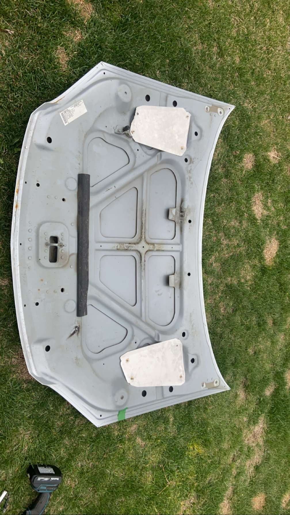

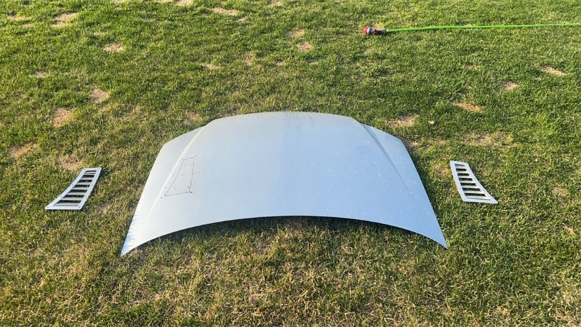

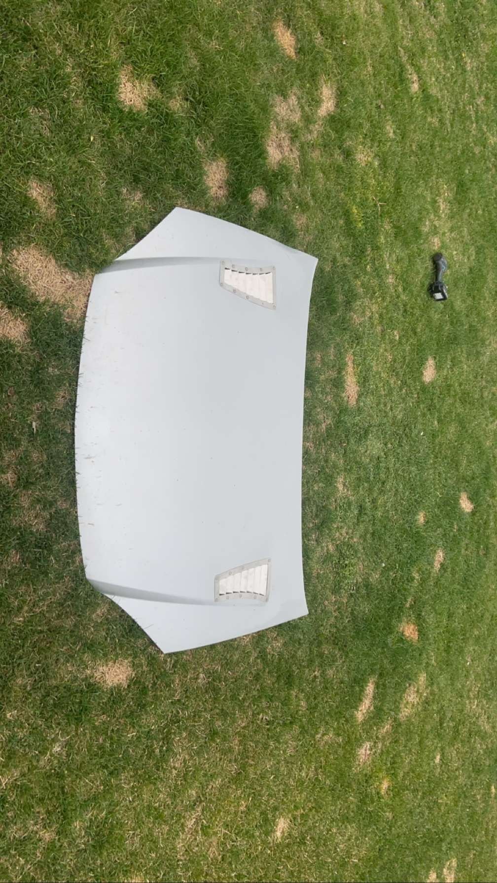

Engine bay temps have been pretty high lately, so I installed some hood louvers with water trays! I think it looks great and already noticing coolant temps are rising much slower
