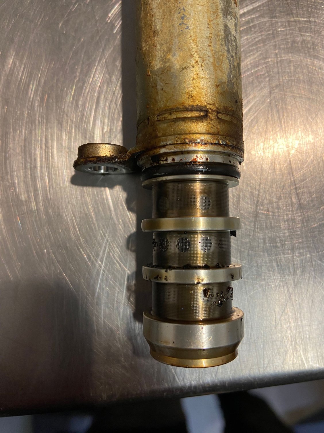

pull and clean the VCT solenoids next, if any shavings on solenoid, replace.
we have narrowed it down to spark timing as your issue, not fuel or VATS
Will do.

so I pulled the solenoids. Little dirty, replaced them as they were dorman went back to oem.
