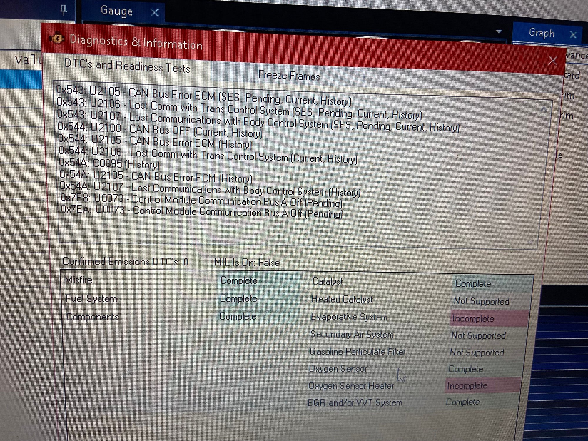

Can anyone identify what modules corelate to
0x543
0x544
0x54A
0x7E8
0x7EA
ive asked hptuners if they can identify them

It’s gotta be a bad ground though.
Bad module should be more consistent.
I’m gonna cut G105 off this weekend should be nice out, I’ll rewire it a few Inches back with a new terminal.

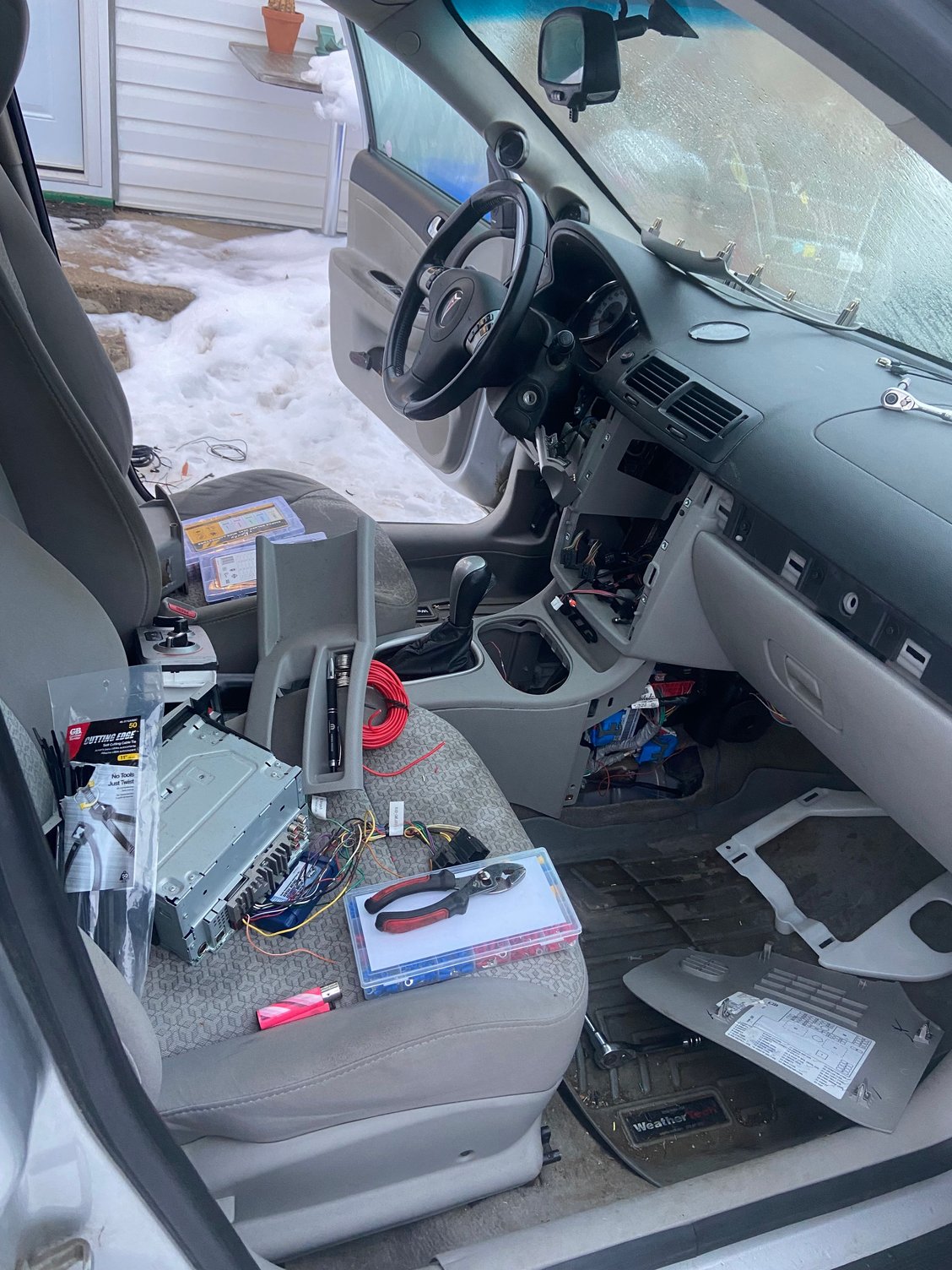

Got a little off point today.
Rewired all the power taps at the BCM, tightened bolts that hold BCM in and rewired all grounds near the BCM.
Hardwired my aftermarket radio and got rid of all butt connectors in that area.
*found an exposed wire between the radio and aftermarket gateway module*
-Kinda want to wire up my hands free controls while I have it all apart.
moving towards the drivers side now though, gonna clean up Methanol controller, Wideband and Interceptor gauge get rid of all my rats nests.
then tomorrow might be g105 day, remove my intake and try to get as much room as possible. Knees are starting to get cold and stiff haha

Really happy with today. Been wanting to redo my radio wiring for a long time.. took a lot of junk out.
and with a lot more room was able to get a good look at the dlc connector and I may have found my smoking gun. An exposed Tan wire! Gonna be hard to repair, 20 more min of sunlight let’s go!
