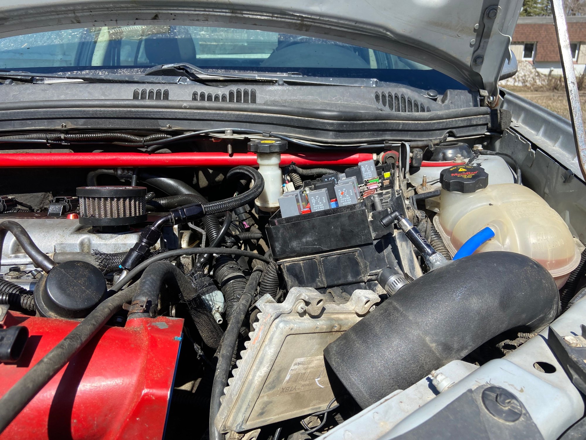

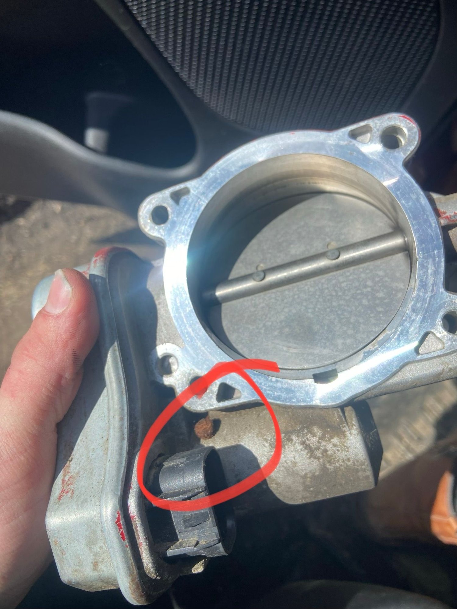

removed my fuse box, swapped ecu. Cleaned up some grounds a tad. Swapped throttle bodies and I’m now just waiting for my laptop to boot and see what happens.
Found a magnet on the back side of my TB, that makes me super optimistic about this now lol!

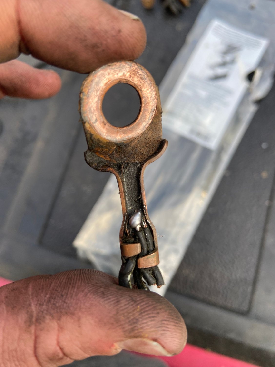

Rewired G105 and cleaned up ground strap.
Gonna get some more gas tomorrow.
Acquired a new fuel filter today, new fitting should be here Thursday.
Need to get a filter on the top of my vent hose.
Then if it’s still being mean, I’ll test the maf harness next

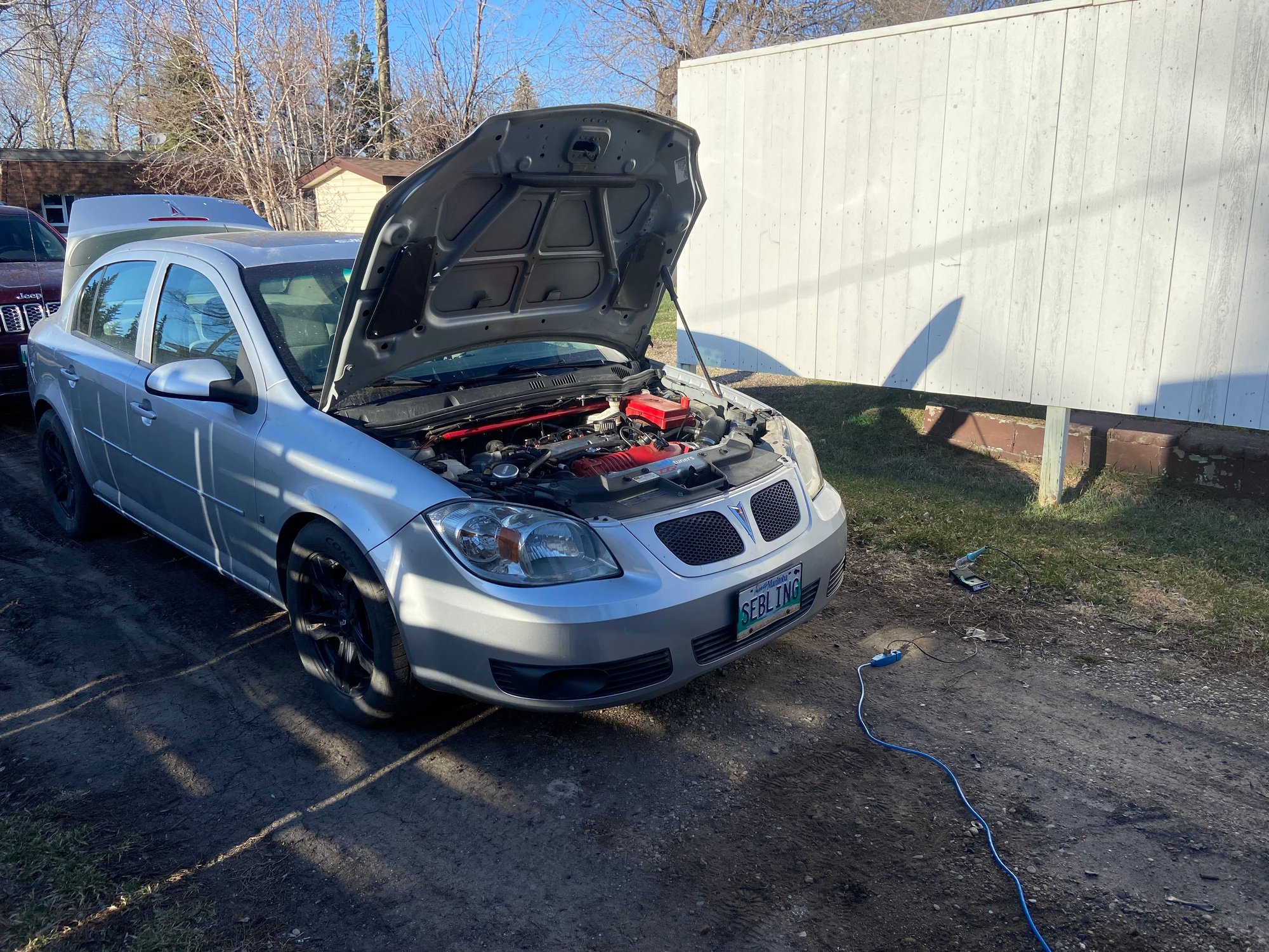

Photo dump for proof of work
G105
