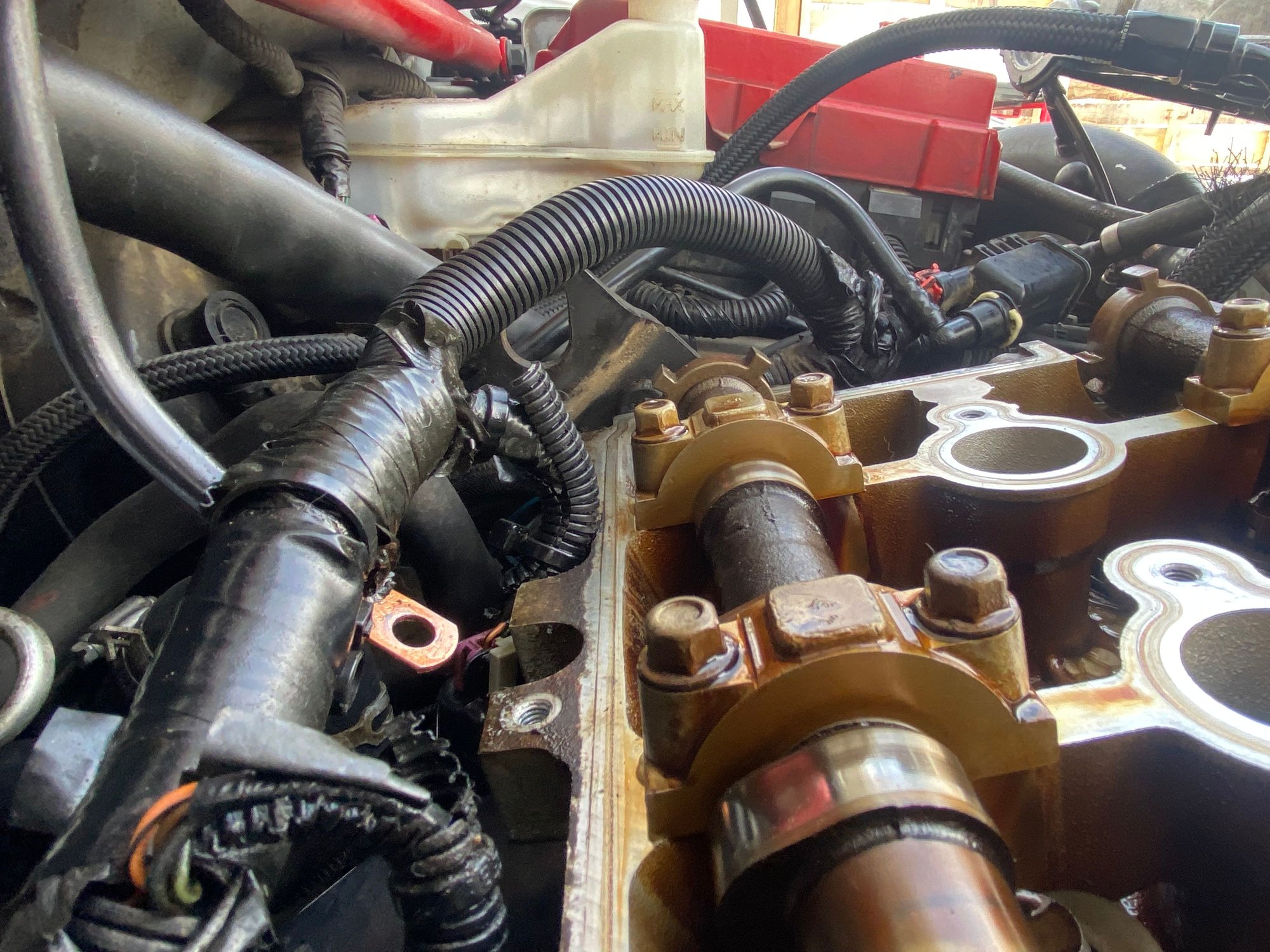

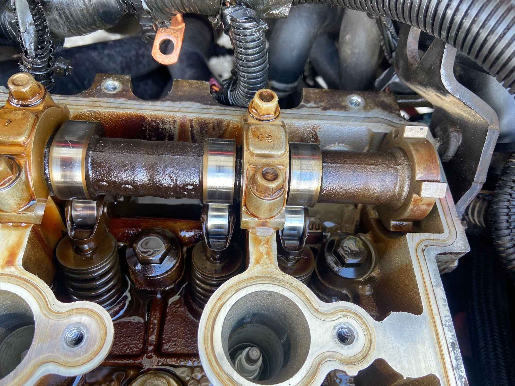

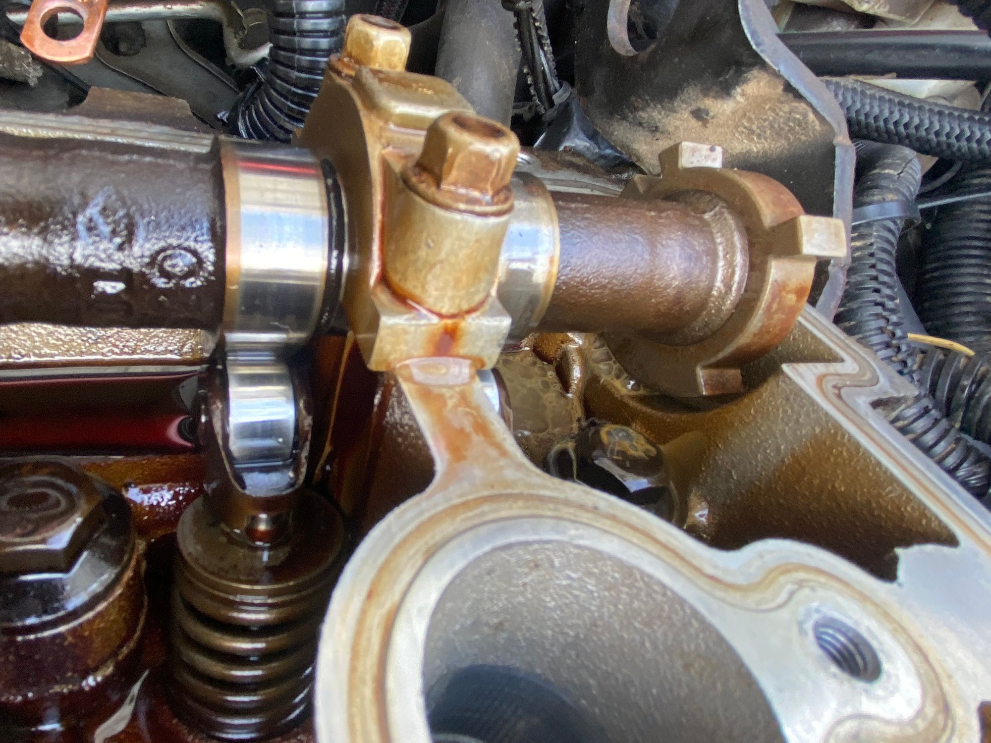

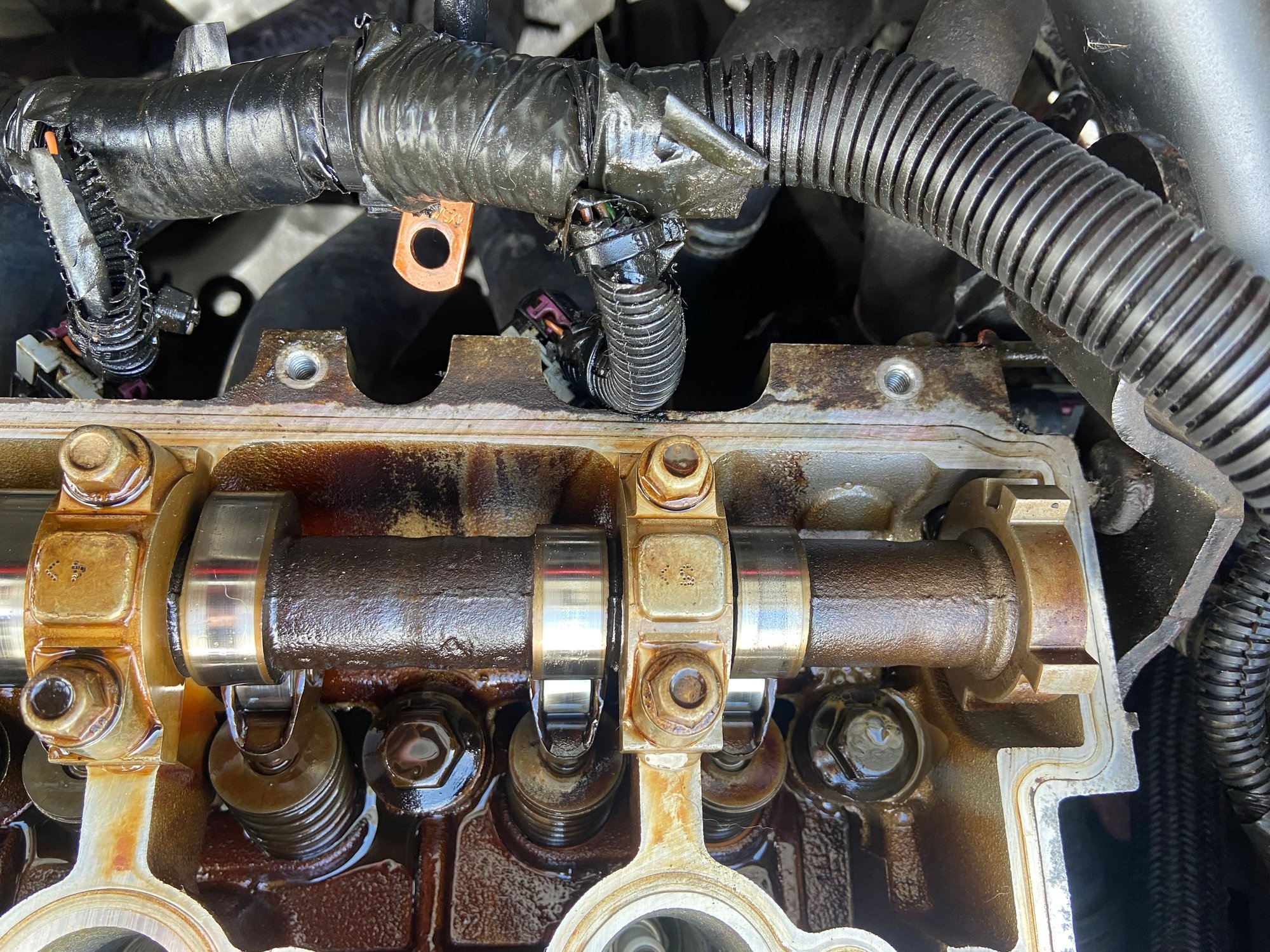

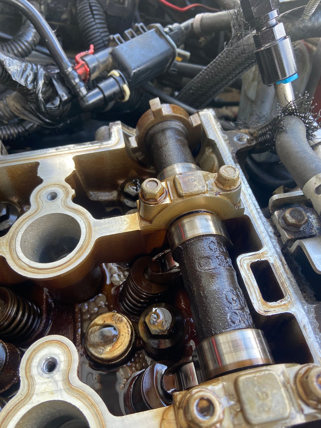

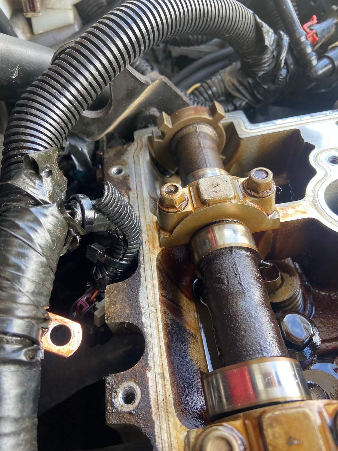

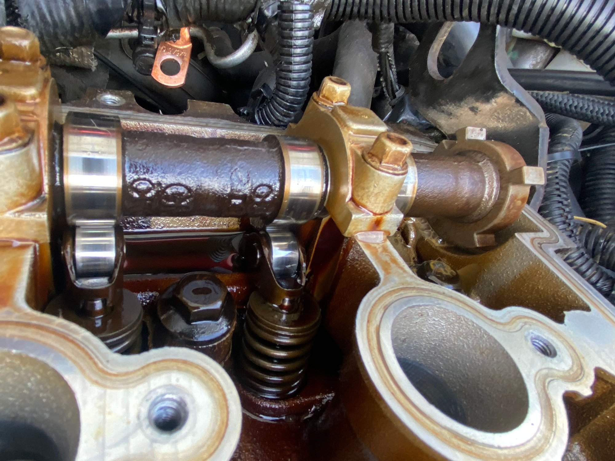

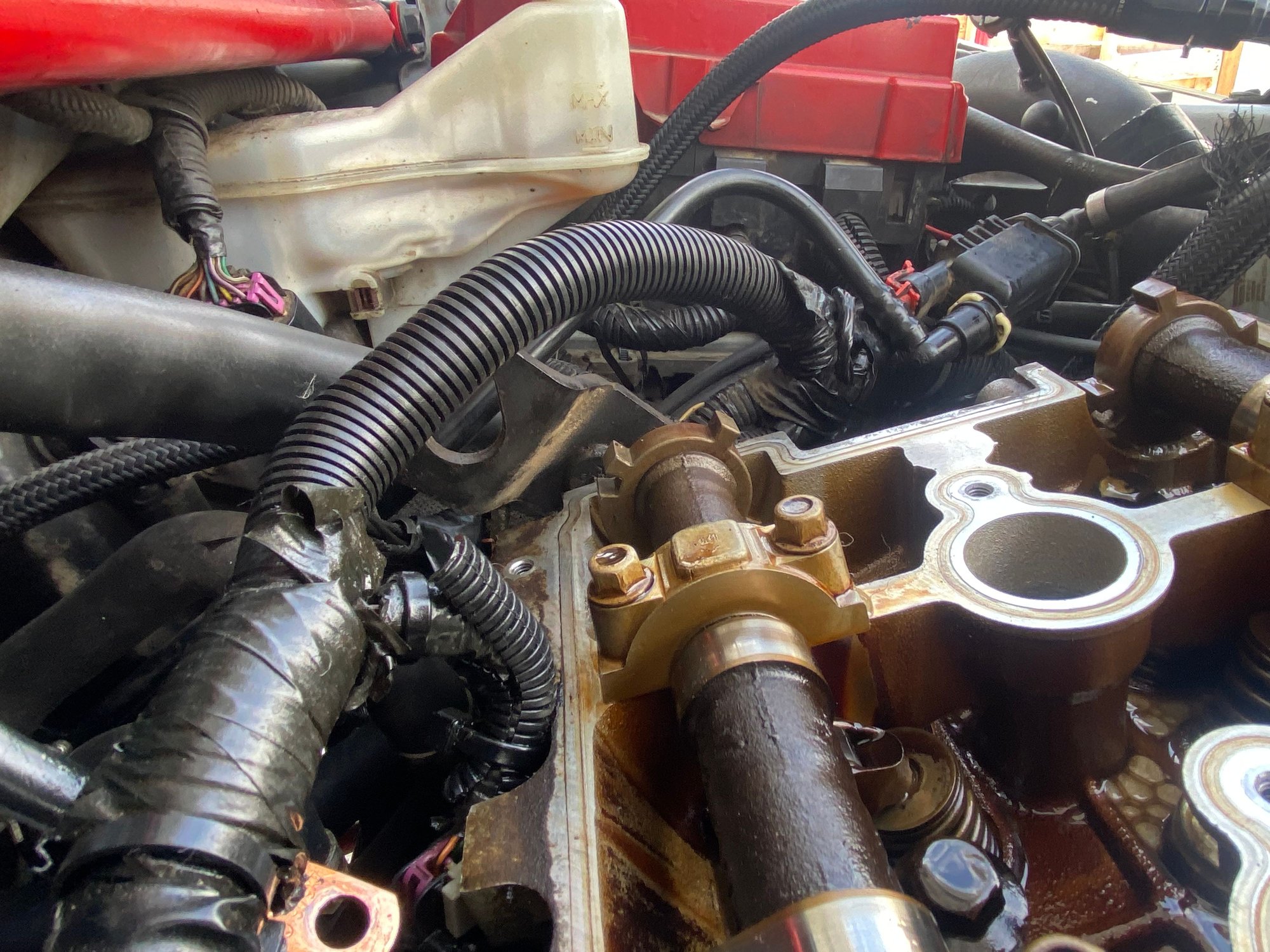

Old Jan 21, 2024 | 02:23 PM
  #1220
G5ALIVE's Avatar
Joined: 07-04-18
Posts: 967
Likes: 139
From: Oak Lake
Looks like it’s in roughly the right spot

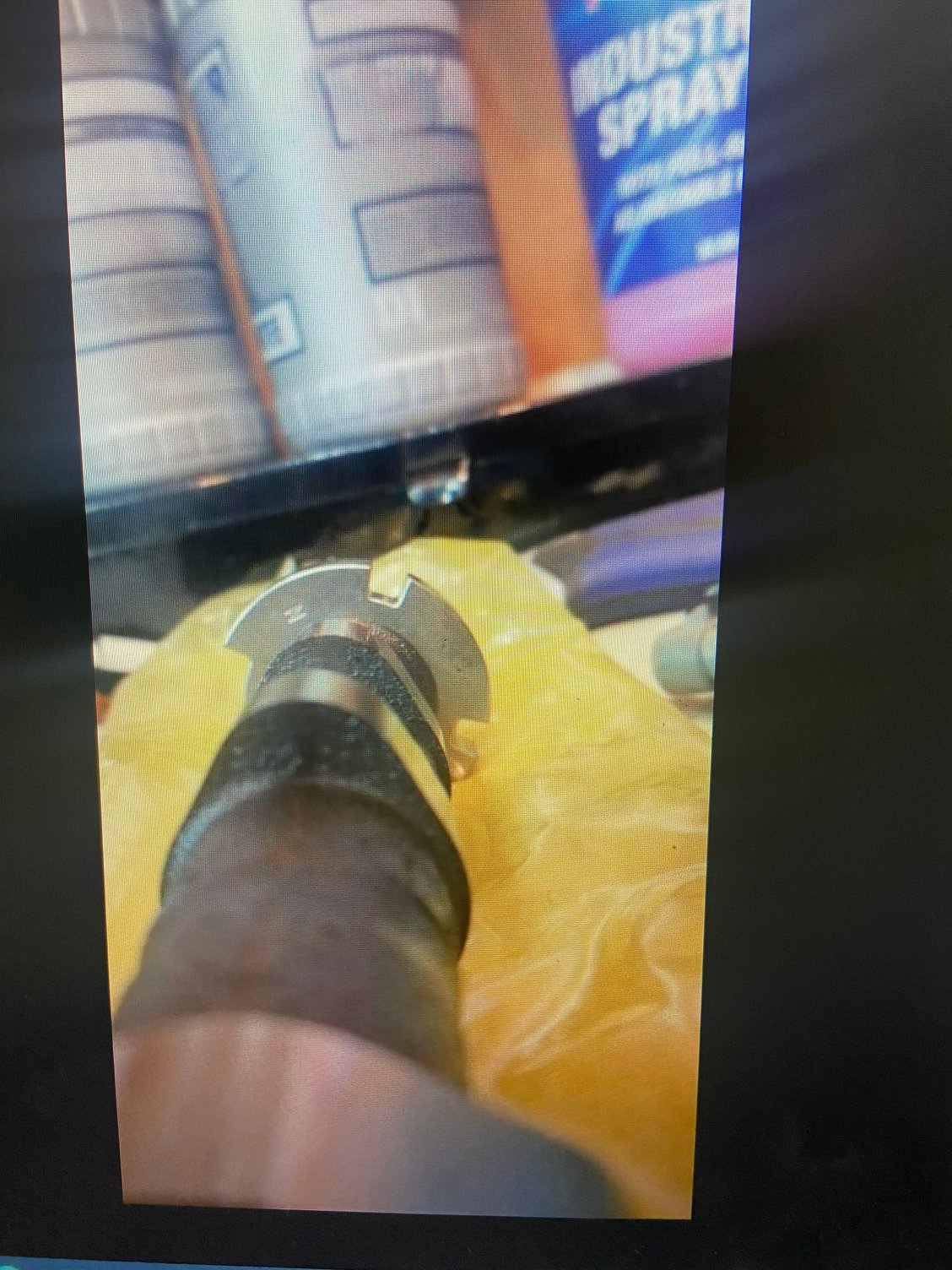

Old Jan 21, 2024 | 02:54 PM
  #1221
G5ALIVE's Avatar
Joined: 07-04-18
Posts: 967
Likes: 139
From: Oak Lake
It’s 180 degrees upside vs this but looks the same.
Old Jan 22, 2024 | 09:39 AM
  #1222
G5ALIVE's Avatar
Joined: 07-04-18
Posts: 967
Likes: 139
From: Oak Lake
Got a new cam in front of me and it looks the same, if its off its gonna come down to a single millimeter
