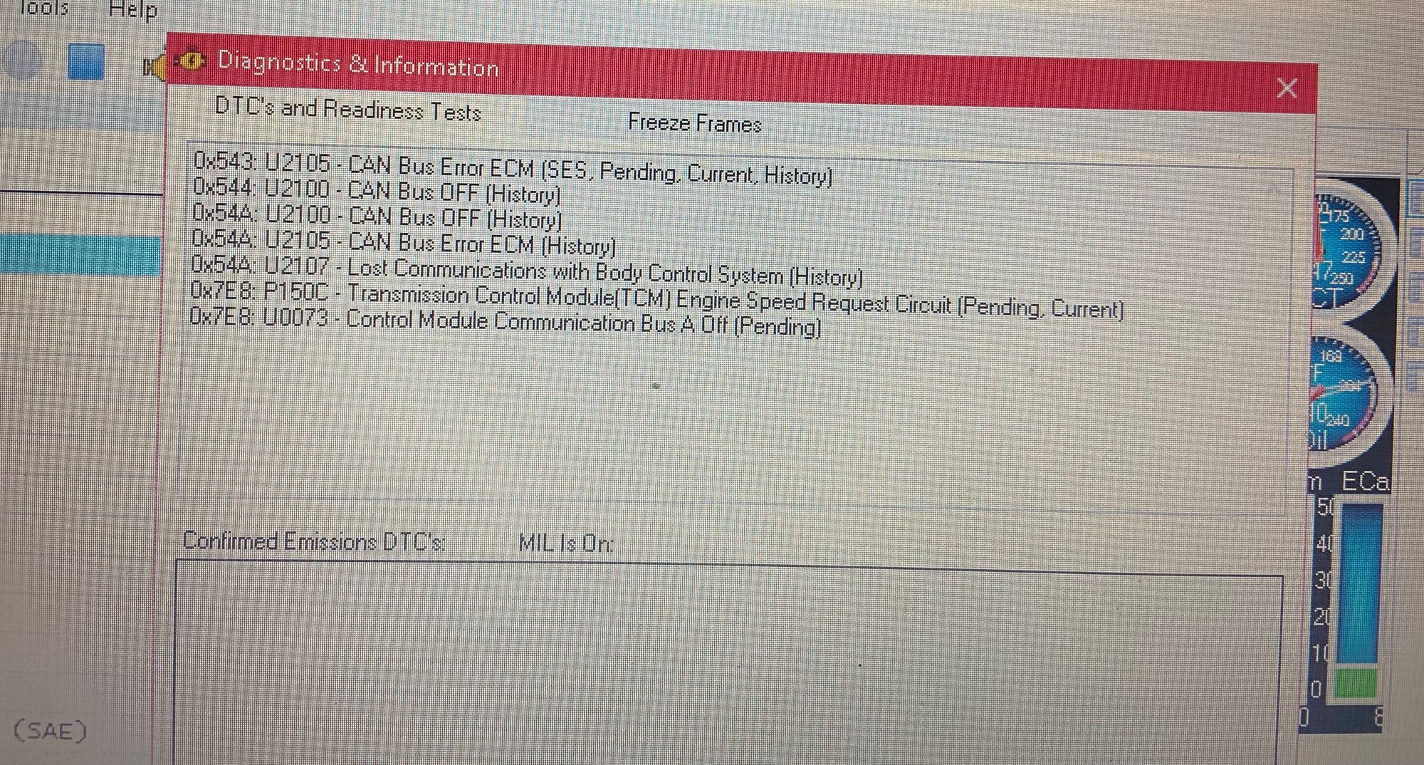

Hmm, going back on data files across several years it’s not uncommon for my car to start with 11.13, 11.58,11.8, 11.49, 11.15 and that would be through obd so same charge my interceptor would pick up.
Well we’re going out with the laptop see if I still have communications codes and to add ground wires.

Okay, so the battery in now is much better but not the cause of my problems though.
Now, I removed my interceptor and swapped to my laptop several times seeing if I could cause the issue, moved and pulled on some wiring.
On one occasion, the split second I plugged in my laptop cable it set off some chimes and there was a basic u0073.
and on the only other occasion while moving the obd port a little it started to sound slightly off so I looked up my whole dash was acting up and I pulled all these codes

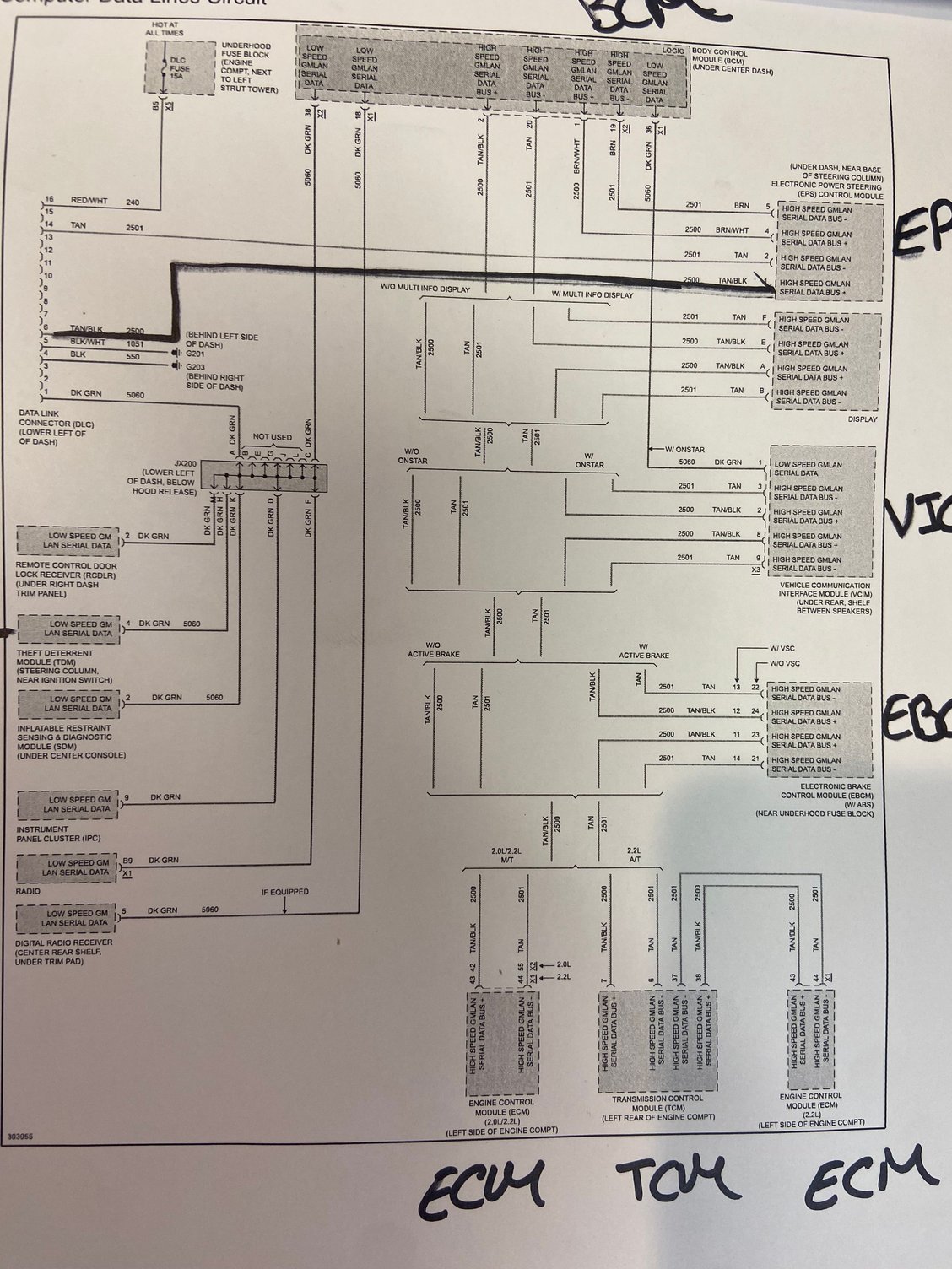

A remote start install was attempted on this car about 6-7 years ago by a shop Forman, the skematics in the box were wrong and the car was wired back up without the remote starter system.
there is a slight amount of corrosion on one of my interceptor terminals. Pin 6 high speed GMLAN.
however my hptuners cable does not.
yet it’s happened a few times now where it acted up exactly when the hptuners cable was plugged in.

It’s gotta be something with the VICM, pulling the black connector outs sets a u0073 and P1501 theft déférant system which were the first codes it ever got.
now I think I may pull out my carpet see if I can spot a bad wire. Re seated the connector several times and my start up is super crisp right now

It’s got to be right at the obd connector cause moving it around will set off the codes. So either my cable or the high speed lan leading up to the obd.
i just find this odd because the problem this is creating, in the mornings it fails to start first try, engine starts and runs for about 1-2 second, dies. Restart is super strong like it didn’t have enough fuel the first time or failed to communicate with anti theft module but no codes are stored when this happens.
codes only trip when I move the connector or maybe once every ten times this happens.
