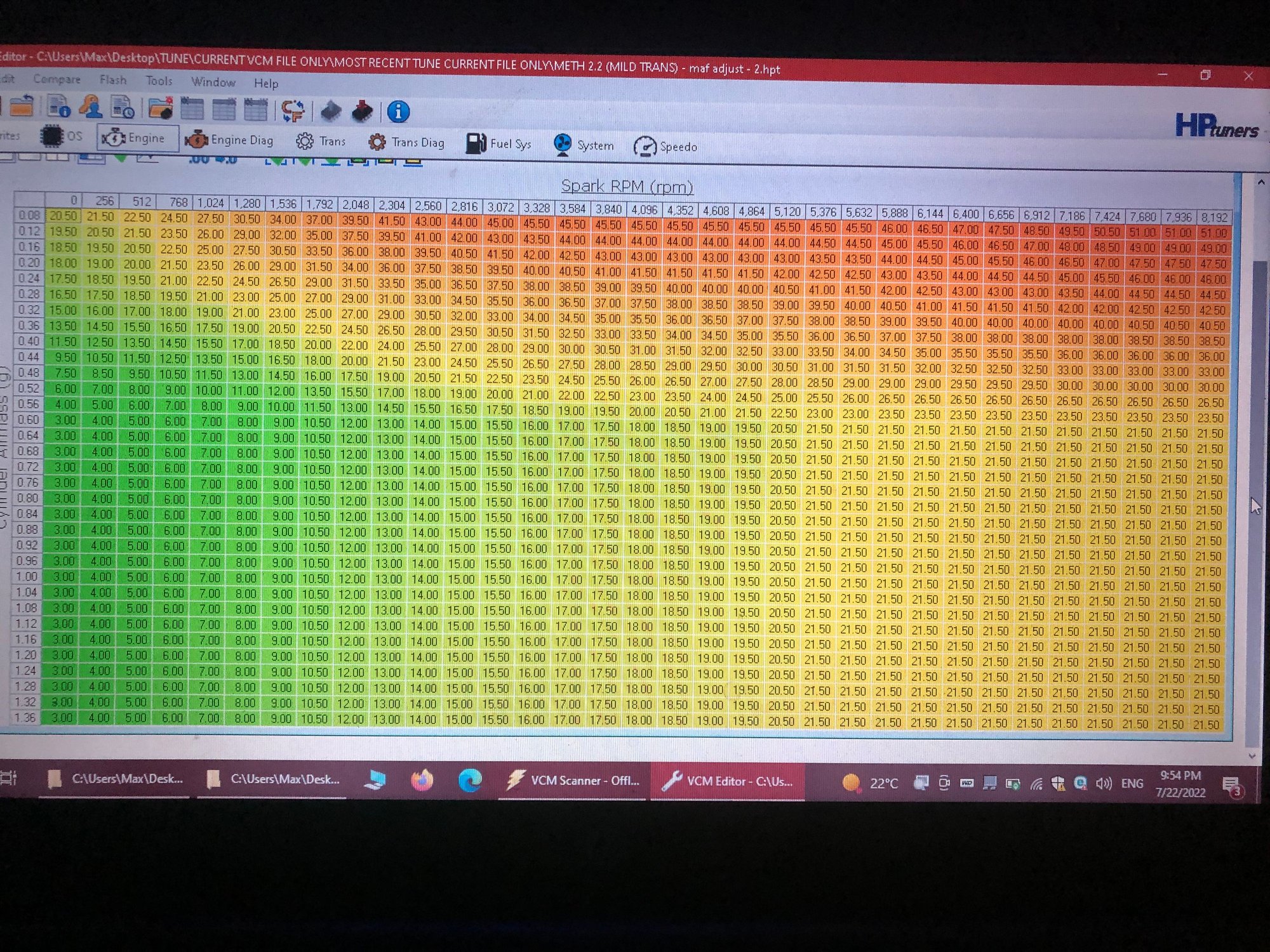

Added 0.5 across the board and wow what a difference. Car is very spicy. Might add another 0.5 and drive it for a little while make sure everything’s good. But no KR, AFR is mint

Going to add another 0.5 of timing, all the numbers look really good, but it's making more noise lol so it's a little scary yenno haha but I'm pumped!!

I think another little bump in timing and I'll be hitting 3rd gear at 130km/h. It was being a little slow on the 1-2 shift but that extra timing just smoothed it over completely. I'll maybe take another video of me driving home tonight, amazing what just a smidge of timing can do

seemed to slow down in 3rd this pull, idk what timing was like but afr and knock still looking good. Might add just a smidge more lol bring my best for next week

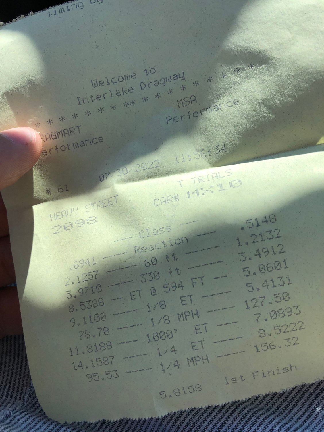

14.1 and then someone dumped their trans fluid on the strip. Turned it up it’s gonna be nice and cold for the next pass 13.9 or blow lol

Like 6 cars had break downs on the strip. Spent 5 hours sitting in my car made 2 passes 14.1 was the best, new record, but man so so close I can almost taste it.

Still street tires. I’d like to break 13s on street tires move to slicks for 12s
but yeah I have no doubt it would’ve done a 13 today. My 2nd pass had a mint 60 foot but the 330 was sloppy.
If I combined my 60 foot and 330 from the two passes it would have hit 13s. Just needed to make more than 2 passes yenno. If I got like 6-7 tries even in this heat it would’ve done it.
but oh well, it’s gonna make it that much more enjoyable when it does break. Try again on a cooler day forsure

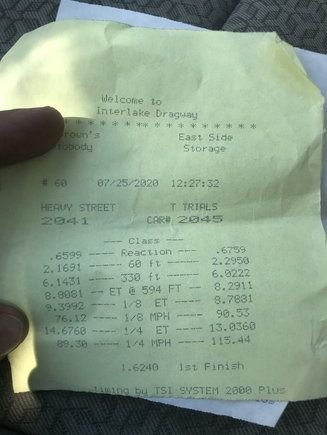

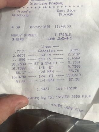

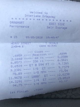

Just so they’re all in one place now and I don’t need to dig for these again.
Did a little better overall since last personal best. Don’t want to blame it on the strip, but the guy I said next to for like 2 hours kept saying “I’ve never seen this much crap on the strip” over and over again and talking like this is sad for the spectators etc etc
Am a little disappointed in myself though only picked up 1.1km/h and 1.3km/h…
I’ve left my aggressive trans shift pressure to get use to it again. The car is pretty happy with 22 degrees of timing, no KR, I might test out 22.5 and 23 if things keep looking good..will be back later this year….Car hit the extreme limiter on the 1-2 and just grazed it on the 3-4 so I can try to clean that up.
I’ll have to practice launching and making note of boost and seeing what makes traction. should be pretty easy in the country
but for the last like 2 months if been smelling something burning when going wot!
Like when my old headers were cracked and with the new headers now. Yesterday I noticed just a little oil on my valve cover so I’m not sure where lol but I think I found a little crankcase leak perchance. Think it might have been the oil filler tube seal, replaced it and will see

Regardless you are still making improvements brotha. And I agree if the track surface is a piece of **** then there aint no way you are going to get good traction. That smell could be anything including the tranny fluid. I know you got the same problem I got with a slow fluid leak. Even after I changed out the old fluid to new fluid plus lucas tranny oil treatment it still leaks from the axle seal. I'm at the point now I'm gunna get another used tranny eventually once it dies.

i agree. Definetly moving forwards not backwards now lol. My 2nd pass that day had a 0.6 reaction time, 60 foot was a little slow but then my 330 was just nothing. The backend felt strong but I knew I could’ve put down a lot more at the beginning.

22 degree’s is spicy. It should do a 13.9 now

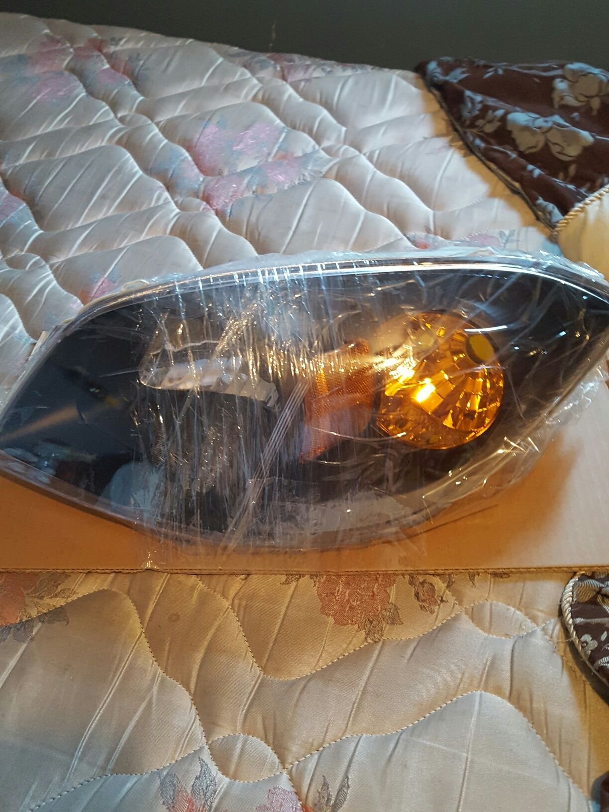

My headlights and tail lights finally came in from ebay brotha lol. They look nice. See how long they last lol

Oh Sick send a pic when they're on the car. My left passenger one is all clouded up :/ been thinking of getting new ones but my car could never do black headlights i think... I know theres one guy who retrofits them with cool leds n **** though, halo lights
