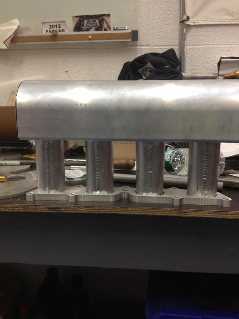

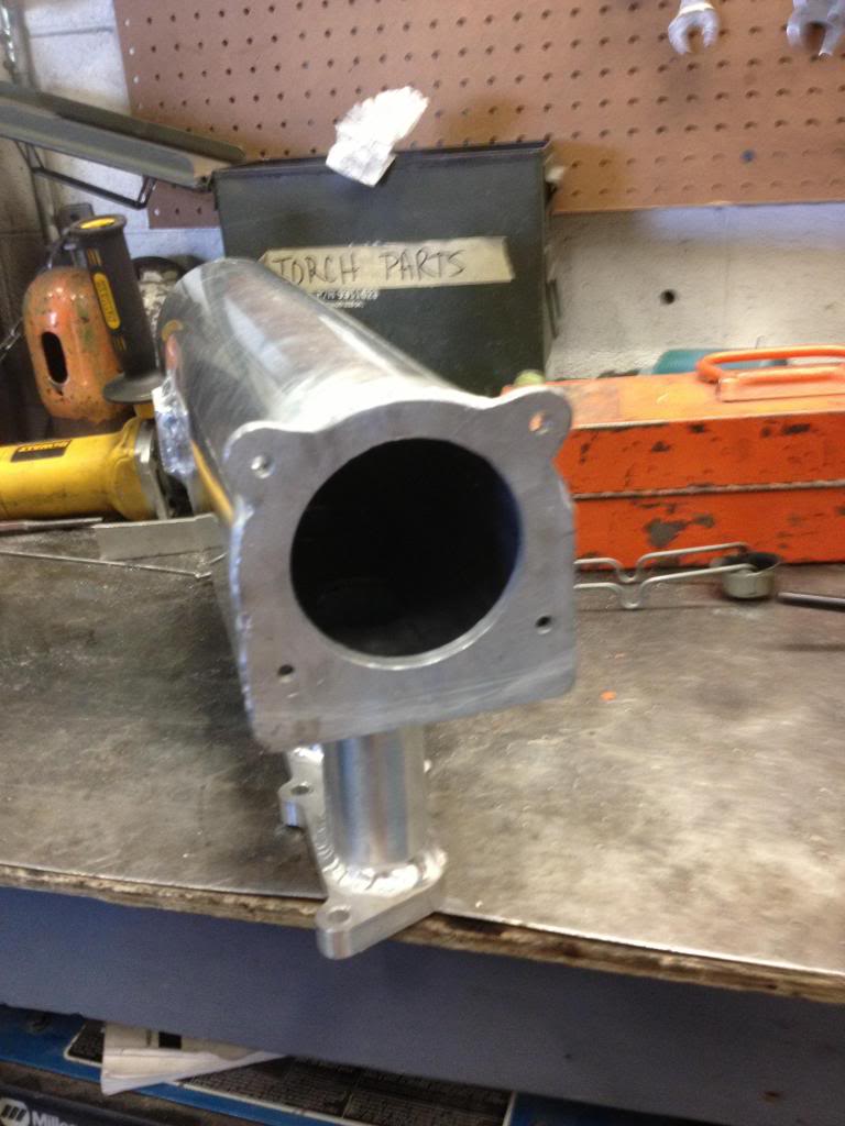

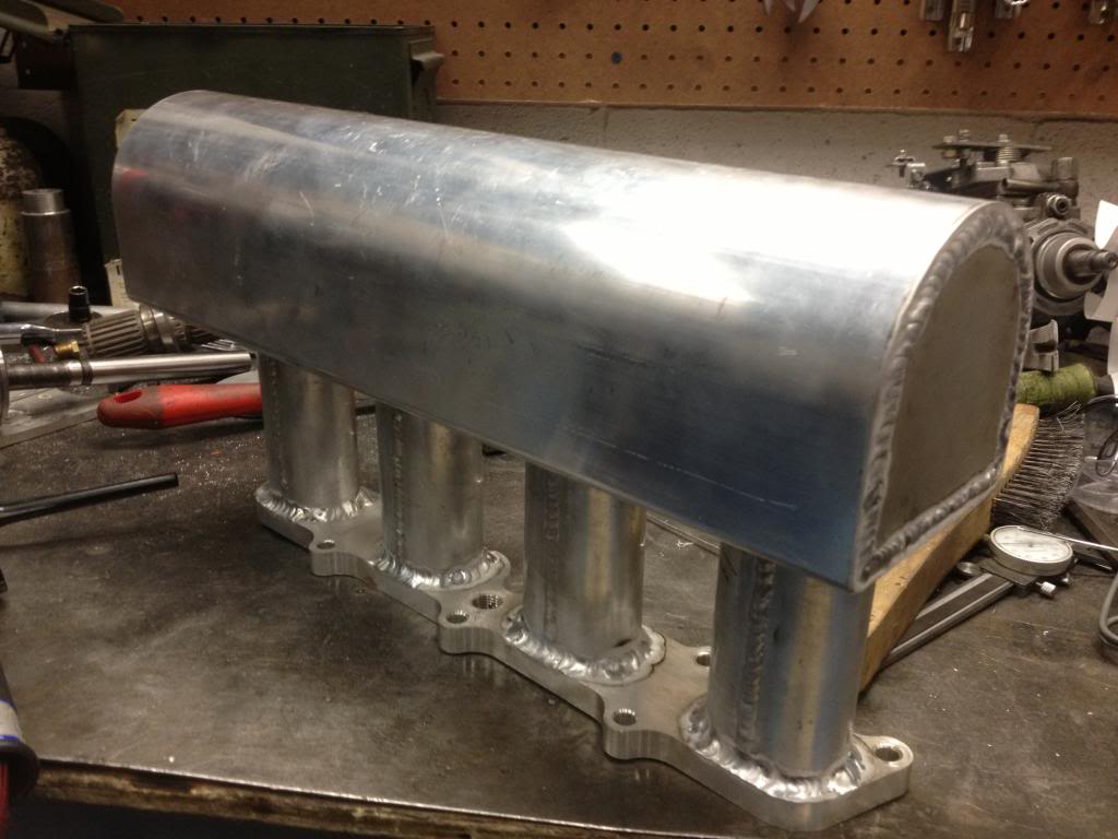

not too much progress, waiting on an extended jaw vice to clamp the plenum with

did you do that by hand or was it programmed?

And noooo the flange was CNC'd lol, but I did put a lip in the runner bores so the runners sit inside of the flange. This makes welding .125" to 1/2" much easier
