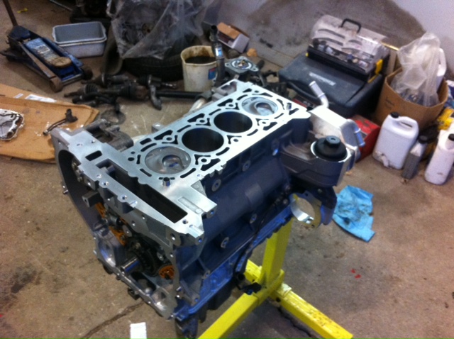

Originally Posted by slitterell
So what did ZZP send you? Do you have pictures?
The only thing ZZP changes to make the LDK work with the LSJ is they modify the reluctor wheel.
The motor:
The oil cooler:

The motor:
Isn't these direct injection pistons? They didn't even swap over pistons?
Yes they are. When I first talked to zzp about this motor they told me the pistons were swapped. I got the motor and was like wtf. Well I guess they thought I was talking about their forged Gen 3 motor for some reason. You can run DI pistons in an lsj it just isn't as optimum. At the time back in October they had already done over 20 of these motor swaps without issue. Going from the lsj to the Gen 3 with DI pistons they said it made no difference in the tune. I'm still just breaking in my motor but so far so good.

Yes they are. When I first talked to zzp about this motor they told me the pistons were swapped. I got the motor and was like wtf. Well I guess they thought I was talking about their forged Gen 3 motor for some reason. You can run DI pistons in an lsj it just isn't as optimum. At the time back in October they had already done over 20 of these motor swaps without issue. Going from the lsj to the Gen 3 with DI pistons they said it made no tune. I'm still just breaking in my motor but so far so good.
I hear you. I was just making sure you knew. what kept you from buying Pistons to install?

Well I really didn't want to tear a motor that was just apart back apart again. Second was money. I went through 3 motors in a year. Had some bad luck. And the Gen 3 motor in it's stock form is good for over 500whp. If I want more than that I'm going to buy something with 4 more cylinders. Granted a forged piston is stronger and less likely to fail, this motor should be able to take what I'm going to throw at it with ease.
I've only been ripping around on it with low boost. I'm itching to turn the dial and see what this S252ET can do. But so far no complaints with it at all.
